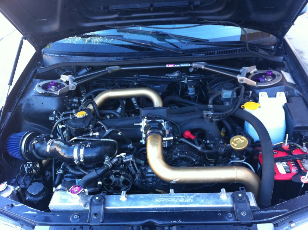

QUOTE (Malek @ Sep 8, 2013 - 12:58 PM) *
Yeah, the little J-bars at any local car shop is what holds down the battery. There is a hole on the front and rear side of the battery in the compartment that you hook the J's into. There is also a flat metal piece that goes over top of the battery that slides over the J-bars. Pic may help. And it can still be held down without a tray..
This was in my Subaru. Same exact battery tie down setup as the celica
PS Cables were shipped. Forgot to send you a pm haha
Thanks for the pic. So I'd just need the j-hooks/bars and the metal piece that goes across the top of the battery then? Sounds easy, I'll try out.
