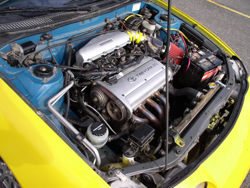

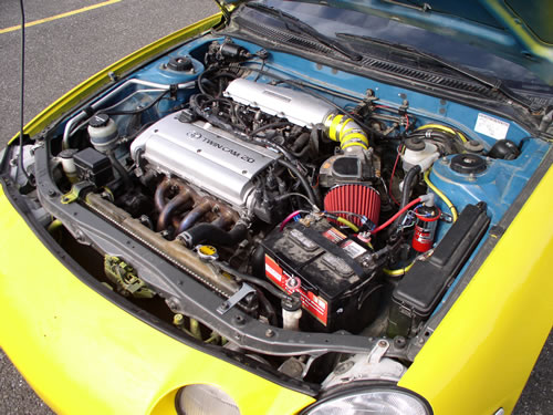

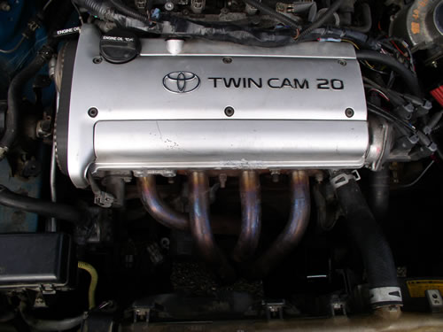

Anyway, here are some pics.
Check out that header. smile.gif When I was at the gas station earlier today checking the oil, a couple guys asked me if it was DC Sports or what. When I told them it was stock, they looked pretty surprised.

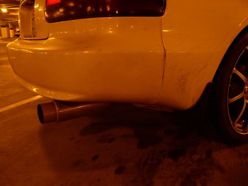

Here's my new exhaust tip. I'm running the car without a cat for now, and it's crazy loud. I'm pretty sure that I'll get pulled over for it unless I do something about it. wink.gif

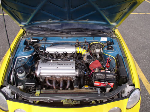

I know, I know, I need to paint the engine bay really badly. Over spring break I'm going to tidy up the wiring and paint some stuff and clean some stuff. smile.gif
