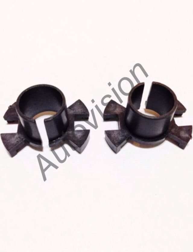

I've been running HID's in my projectors for a couple of years now. Per this thread, I've always used the plastic ring that came with my HID bulbs but at any given point in time, one bulb will sit properly and the other wants to sit crooked in the housing. I've decided to give these a try.
They're adapters that hold the H1 HID bulb for a Honda, and make it sit properly like a regular H1 bulb. For only $7, it's not a huge loss if they don't work, but I suspect they'll work better than trimming the plastic ring that came with the HID bulbs. I should have them next week and I'll get them fitted ASAP.

- - richee3   Will do. Turns out the Honda guys have been having...   Jan 4, 2014 - 1:34 AM
- - richee3   I received the adapters today. Test fitted with a ...   Jan 6, 2014 - 4:20 PM
- - richee3   Got these installed today. Still waiting for my fi...   Jan 7, 2014 - 4:25 PM
