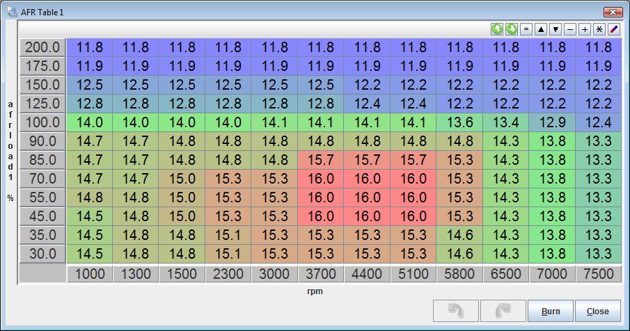

I grew a pair and did some runs while having an eye on the a/f-gauge. And the ratio drops to around 10 when flooring it. Very safe then:) When at idle or cruising you want to be at 14.7 because there is not much load on the engine and the turbo is not really doing anything. Once you floor it and boost builds, you want that ratio to get richer to supply more fuel to the extra power you are making. Normally when people talk about what afr their car is running, they are referring to the afr under wide open throttle and at full boost. Here is a good visual example of the type of look up table your ecu uses. The 100 load on the left is 0 psi, and the 200 load is about 15 psi. http://www.miataturbo.net/attachments/mega...-afr_tablez-jpg -------------------- 15PSI - 30MPG - Megasquirt Tuned

Box The stoichiometric ratio is 14.7:1 Apr 11, 2014 - 3:36 AM

playr158 10:1 is very safe
12:1 is reasonably safe
14:1 is ... Apr 11, 2014 - 9:45 AM

Box Yeah, was going to say especially being a turbo it... Apr 11, 2014 - 2:39 PM
Smaay depends on what you are doing. 14-15 is just fin... Apr 11, 2014 - 10:10 PM
