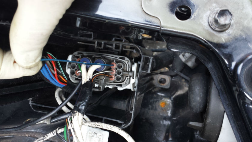

Need a little help with this wire blue with black stripe, can't find the other end. Not sure if its a left over from the 7afe.

- - Defgeph   Need a little help with this wire blue with black ...   Jun 6, 2015 - 2:47 PM
