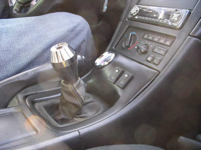

post Apr 13, 2004 - 12:24 AM
I just completed my interior panel yesterday. smile.gif It didn't turn out near as well as I'd hoped it would, but I can always modify it some more until it's perfect. smile.gif

- - Coomer   I just completed my interior panel yesterday. It ...   Apr 13, 2004 - 12:24 AM
- - ghostdog   looks pretty good. but I would create some sharper...   Apr 13, 2004 - 12:41 AM
- - doGGy   Sanding, sanding and more sanding I hate that par...   Apr 13, 2004 - 2:00 AM
- - Drocay   wow coomer from the pic u should me yesterday that...   Apr 13, 2004 - 2:02 AM
- - Yobbe   Thats a pretty nice setup, but i guess you prolly ...   Apr 13, 2004 - 3:44 AM
- - celicarocker   did you make a whole new piece of just modify the ...   Apr 13, 2004 - 12:31 PM
