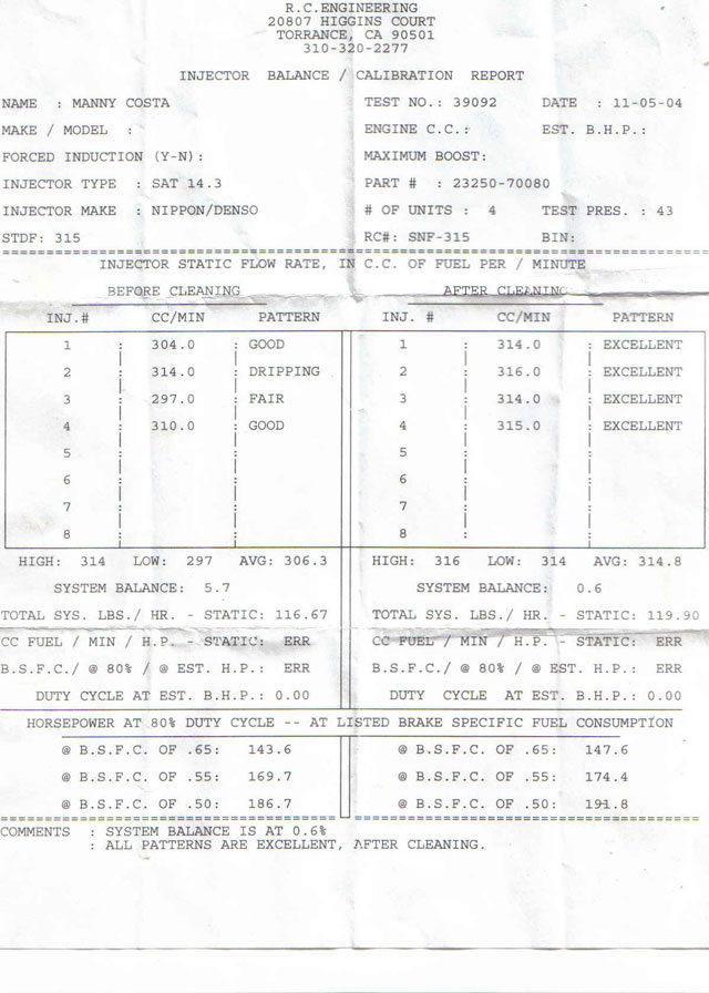

Fuel Injector Mapping <- For if you want to have your injectors cleaned and mapped.

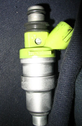

For the 5sfte project, this is simple. Supra NA 360cc injectors, and a Supra TT fuel pump. You can get larger size injectors if your boost requires it, and you should also look into a Fuel Management Unit (FMU, at least I HOPE thats what that stands for). This will cover you up to 12 psi and beyond; a FMU and boost controller like the Apex'i Super AVCR will show you the current load on your injectors, and from there you can make a decision based on how large you need to go at your current psi level (if you're at 55% load, you're pretty friggin safe, if you're at 97% load, somethings going wrong or you need bigger injectors).
There also seems to be a lot of confusion about which injectors are the "green-tops". The following is a picture of them, and the flowtest data to confirm (thanks to presure2 for these):
