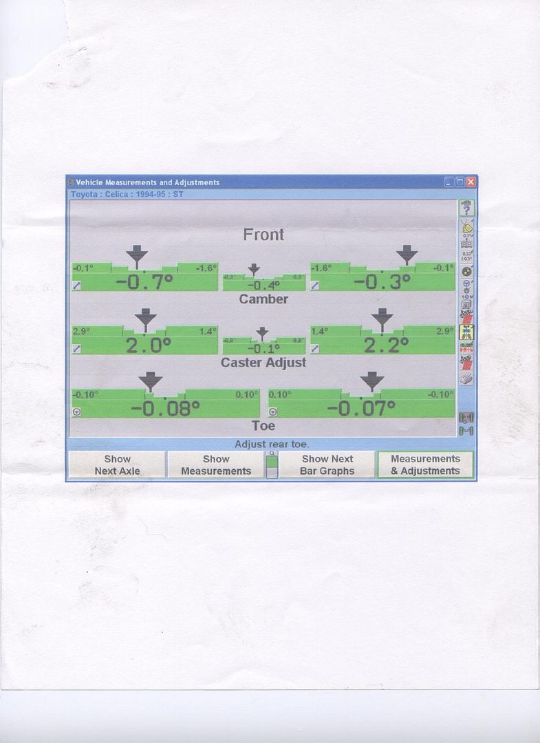

Ok, I did a search but couldn't find exactly what I was looking for. Does anyone have the factory alignment specs (caster, camber and toe) for the 6th gen? It would be on the print-out if you've had your alignment done at the dealership.

big pics were nessesary here, hope this helps...
