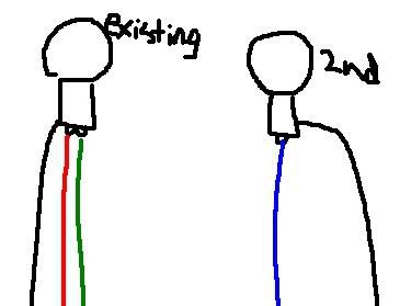

this also happened to me, it happened when i tried to splice my second brake light from both my existing brake light and my night time driving light. (since the second brake light only has one pole, whereas the normal brake light has 2 poles)
the left bulb is the normal brake light, the right is the brake light that doesnt trurn on (for aussie cars anyway)
i was trying to get both of them to light up, but since the right only has one connection on the bottom, if i connected both the red and green wires, it would do what you described above, so i only spliced in the red (brake) wire. so what it does now is stay off when i turn my lights on, but lights up when i brake
so unless youve done that.. tongue.gif id suspect its a short somewhere.
