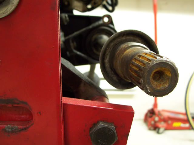

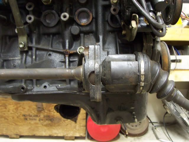

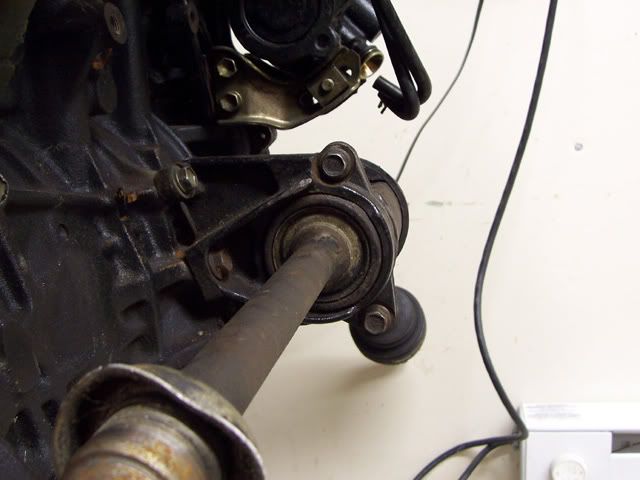

im not sure where or how the carrier bearing is hooked up or used!

![]() ![]() ![]() Should this be so close to the block?

WannabeGT4 QUOTE(zipstrips @ Oct 20, 2005 - 6:34 AM)im n... Oct 20, 2005 - 9:24 AM

lagos you also need to remove one of your intake manifol... Oct 20, 2005 - 10:55 AM
WannabeGT4 Checked it out on my lunch break. The carrier bear... Oct 20, 2005 - 1:41 PM
lagos QUOTEChecked it out on my lunch break. The carrier... Oct 20, 2005 - 2:40 PM
