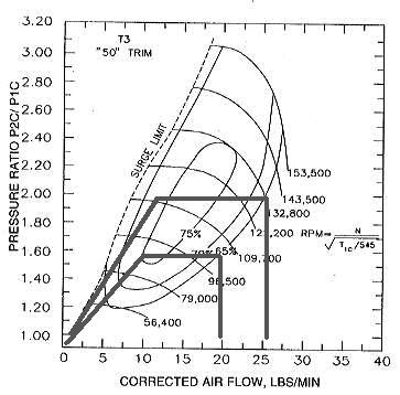

playr158, I'm going to have to argue with you on that. Here are my calculations, feel free to point out any errors.
1.8 liters x 61.02 = 109.8 cubic inches. (playr158, your calculations seem to be based on an engine with about 77 cubic inches, or about 1.3 liters???)
109.8 x 6500 (max RPM) x .5 (4 stroke engine) x .90 (approx. VE) / 1728 = 185.8 CFM
If he's running about 7.5 psi (he actually wants to run 6), then that's a pressure ratio of 1.5, 15 psi being about 2.0.
185 x 1.5 = 278 cfm at 7.5 psi
185 x 2.0 = 371 cfm at 15 psi
At sea level and 85* (less than ideal conditions), the weight of a cubic foot of air is .073 pounds.
278 cfm x .073 = 20 lbs
371 cfm x .073 = 27 lbs
Now here are the compressor maps. (Hand drawn, bear with me) smile.gif The top line is 15 psi and the bottom line is 7.5:
As you can see here, with the T3-50, the turbo will give good efficiency in the lower/mid range, but nearly runs right off the map at max RPM, right when the need the coolest air most!!!

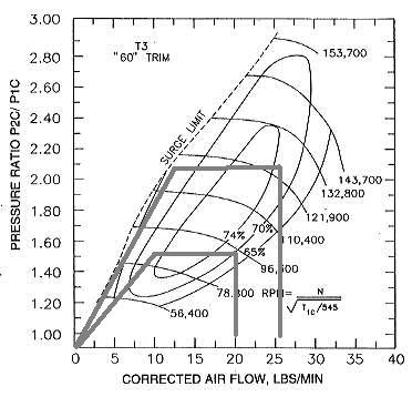

The 60 series runs a little better, still giving preference to the mid range.

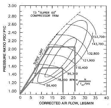

Lastly the Super 60, which is giving it's highest efficiency right where you want it, in the mid/high range right where the most POWER is being made, and where cooler air is MOST important! smile.gif And playr158, since you mentioned Maximum Boost, remember what Corky Bell says, "I'll go for the high side EVERY TIME!".
The best choice then, for a 1.8 that revs to 6500 rpm, is the T3 Super 60.
