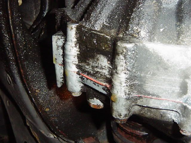

i have some sort of leak and i don't know what it is. the liquid is pretty slimmy with little to no color -> clear. (it might have a slight tint of dark oil color to it in some places). the leak is near the oil pan. overnight, the puddle becomes about say, 8cm in diameter. the fluid has no smell to it.
do you guys know what it could be? i can't find where its leaking from even if i go under the car. the car runs fine too. My friend says it could be transmission.
help me please!

QUOTE(Shigexile @ Jan 12, 2006 - 10:05 PM) [snapback]377892[/snapback]
is the big fat thing in the middle of the engine the transmition?
i'll post pics in a sec.
here it is ->
you could see some dripping down
anybody wanna help me?

- - AMCMoe   tranny oil wouldn't be clear. it's thin b...   Jan 12, 2006 - 10:20 PM
- - Shigexile   ^ everynight. its slimmy so i don't think its...   Jan 12, 2006 - 10:28 PM
- - pure_dx   could be coolant from your waterpump seal, its hap...   Jan 12, 2006 - 10:31 PM
- - Shigexile   Sorry, i'm posting this AMCMoe QUOTEHey, Funn...   Jan 12, 2006 - 10:39 PM
- - AMCMoe   yeah tranny = transmission. I think the brake fl...   Jan 12, 2006 - 10:51 PM
- - Shigexile   is the big fat thing in the middle of the engine t...   Jan 12, 2006 - 11:05 PM
- - Bigmeanbulldog55   Power steering fluid is clear and somewhat slimy. ...   Jan 13, 2006 - 12:38 AM
- - Shigexile   QUOTE(Bigmeanbulldog55 @ Jan 12, 2006 - ...   Jan 13, 2006 - 12:47 AM
- - Shigexile   QUOTE(Shigexile @ Jan 12, 2006 - 10...   Jan 13, 2006 - 2:42 PM
- - Supersprynt   Looks like tranny oil to me. Did you recently fill...   Jan 13, 2006 - 2:45 PM
- - Blakout16   def. tranny fluid. thats the lower point on the tr...   Jan 13, 2006 - 3:09 PM
- - Shigexile   thanks guys helps a lot QUOTE(Blakout16 @ Ja...   Jan 13, 2006 - 3:13 PM
- - Supersprynt   QUOTE(Blakout16 @ Jan 13, 2006 - 3:0...   Jan 13, 2006 - 3:13 PM
- - Shigexile   it seems like its an axel leak   Jan 13, 2006 - 4:49 PM
- - Supersprynt   If its tranny oil - the only way there is fluid co...   Jan 13, 2006 - 5:12 PM
- - presure2   bad axel seal. thats definetly tranny fluid, and i...   Jan 13, 2006 - 8:15 PM
- - pure_dx   here's my advice, you could try paying a shop ...   Jan 13, 2006 - 8:42 PM
- - Shigexile   thanks for your help guys. the parts are 15...   Jan 13, 2006 - 10:41 PM
- - creis   QUOTEis the big fat thing in the middle of the eng...   Jan 13, 2006 - 10:58 PM
- - AMCMoe   $150 labor to replace an axle seal??   Jan 13, 2006 - 10:59 PM
