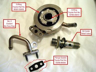

whats up guys...the stock 2nd gen 3SGTE oil cooler has 2 coolant lines going into it. the one closer to the exhaust manifold (the thinner one i guess) is leaking coolant on my 3SGTE. i need a part number or atleast whats this gasket called so that i know what i'm ordering. thnx for any help guys

aright well looking under the car the hose from hell and the hose from hell on earth arent leaking...its that gasket (like i previously thought) shown on the picture that is leaking, part number 16258-88383. think i'll replace the HFH and HFH on earth while im down there anyway...
