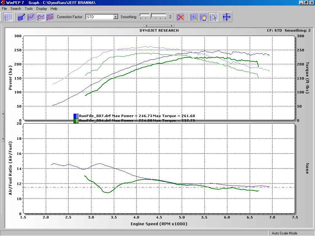

At 17.5 PSI, I put down 246HP and 261 TQ. Just insane.
Look at one of my run files below. I am still having trouble tuning my boost controller. You'll notice that after 4,000 rpm I have very strange spikes in boost. The theroy we have is, the controller is opening and then closing my waste gate door over and over after 4K. In the next few weeks I'll be tweeking the profec to run a constant number, then go back to the dyno. I believe I can squeeze out a couple more horses once this thing is set properly.
If you have any suggestions, I'm more than happy to hear them.

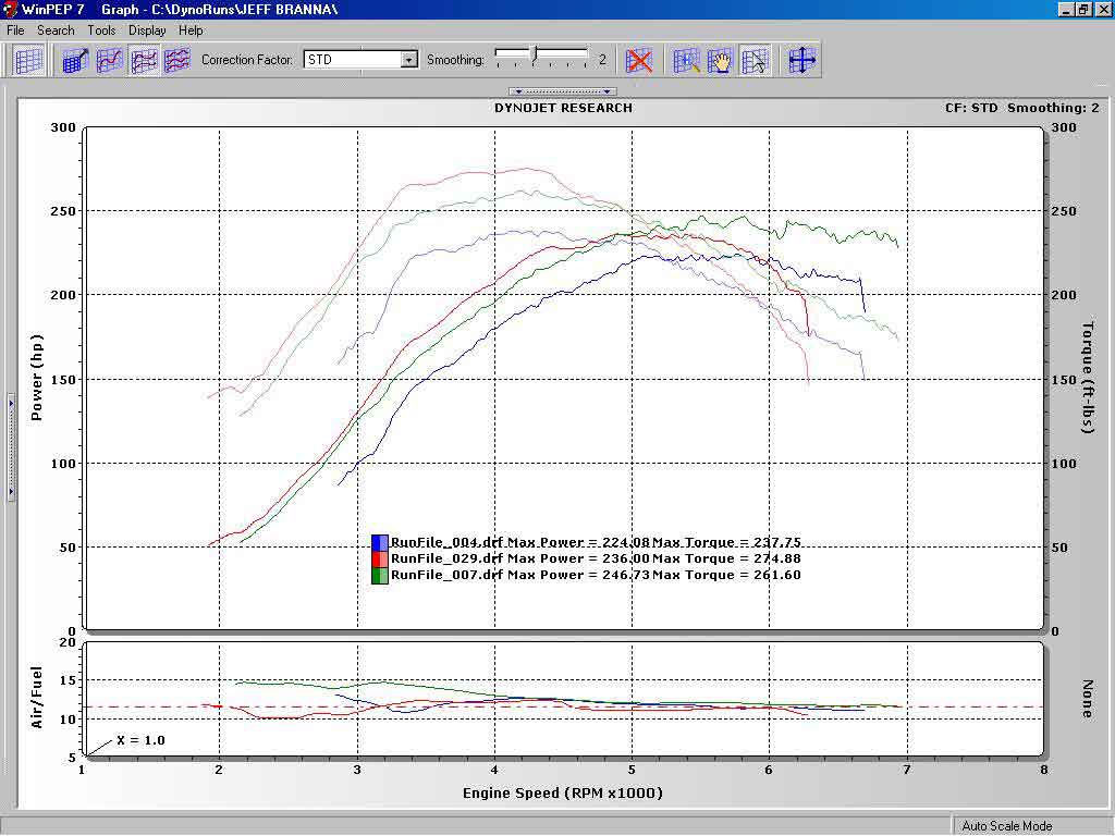

jeffs run is an average if 13.97 psi, call it 14.
with his erratic boost control, it was a spiking up and down.
you can very clearly see the diffrence in the fuel curve there.
IMO you guys should both just relax, you both have awesome, well built, fast cars.
besides, if you wanna start "dyno wars" i have BOTH you guys beat for area under the curve... wink.gif laugh.gif
art in blue
jeff in green
me in red
