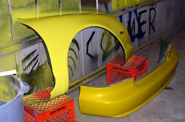

This thread is going to be updated as I do some bodywork and paint my car. I always love these progression threads myself, so I figured I'd make my own this time. smile.gif
Please post your comments as I go along. Since this is my project car and has a salvage title due to vandalism, I'm not doing things that I would if this were going to be a super nice paintjob, like having the rear side windows removed (Average quoted price was $200 around here) and using urethane base coat/clear coat paint (Expensive! And two different types of coats means twice the chances of me messing up.) I'm going to use an enamel of some sort, and going to stick with yellow probably.
Anyway, on with the project:
Day One
Day one started with washing the car with lots of harsh dishsoap and drying it, to remove dirt and some wax. Don't mind the amateur graffiti or the ugly front wheels...Les Schwab screwed up my alignment and it ate my nice Yokohomas up front. frown.gif But do note those sexy sideskirts in the foreground...DCW JDM dealer option replicas, which fit perfectly and are beautiful! Props to Romas for excellent work on those skirts! biggrin.gif
I then removed the bumpers, headlights, tail-lights, trunk lid, license plate bezel, and some other things. My front bumper is being replaced with a non-modified '95 bumper, and I'm getting rid of the fog lights. My license plate bezel and trunk lid are being replaced with parts from a '94 coupe as well, since they were both damaged in the horrible vandalism incident last June.
The next step was to start sanding, so I applied grease and wax remover to the hood and front fenders and wetsanded those with 400 grit sandpaper. I called it a day after wetsanding the front end.

I'm not sure...I now live in a different city and haven't been pulled over once, so harassment isn't a problem until I get back to Yakima. Last weekend I didn't make it through two stoplights before I got pulled over immediately after coming into town.
The rear bumper is my old Spa Yellow Pearl color. The fender was shot with synthetic enamel paint tonight, but I don't like the lightness of the new yellow, so tomorrow I'm going to go check on other colors I could go with.

- - Coomer   Day Five Today was a long day. I started by sandi...   Jun 4, 2006 - 3:06 AM

- - Coomer   Day Six Today I got the paint booth to work reaso...   Jun 4, 2006 - 9:02 PM

- - soulshadow   Coomer what gun are u using for your spraying and ...   Jun 4, 2006 - 9:24 PM
- - b1gr3d   if u got that much orange peel it was probably bec...   Jun 4, 2006 - 11:04 PM
- - dustin15brown   Coomer you are doing an amazing job! Keep it u...   Jun 5, 2006 - 12:53 AM
- - doGGy   Check what Air pressure your Paint gun requers - i...   Jun 5, 2006 - 4:13 AM

- - Coomer   I'm a bit discouraged. I sanded everything dow...   Jun 26, 2006 - 7:04 PM

- - Coomer   Day Seven Today consisted of sanding everything d...   Jun 28, 2006 - 10:26 PM

- - doGGy   Chris - about orange peel - either you are using t...   Jun 29, 2006 - 9:41 AM
- - Coomer   Day Eight Today was a good day...I finally got th...   Jul 1, 2006 - 3:43 AM
- - JFrost9   What did you do to get the paint to work out? I t...   Jul 1, 2006 - 2:02 PM

- - Rayme   are you using a single coat type of paint? (uretha...   Jul 2, 2006 - 10:05 PM

- - Coomer   Day Nine Day nine was tons of work, but I got a l...   Jul 3, 2006 - 8:43 PM
- - b1gr3d   QUOTE(Coomer @ Jul 3, 2006 - 7:43 PM...   Jul 3, 2006 - 10:30 PM

- - Coomer   Day Ten Today I painted the last of the parts off...   Jul 4, 2006 - 8:18 AM
