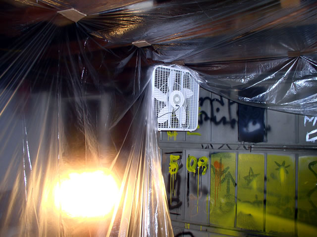

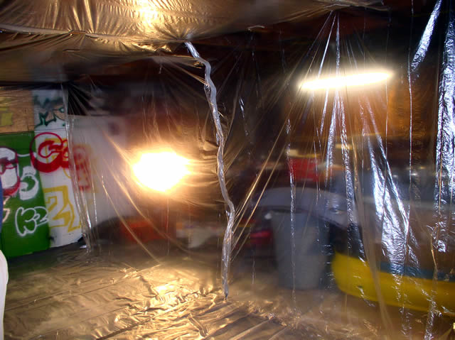

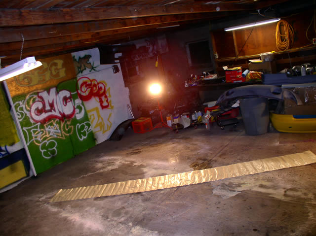

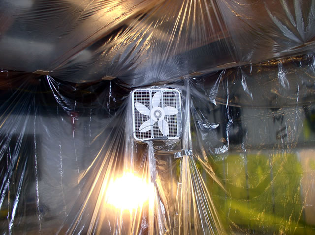

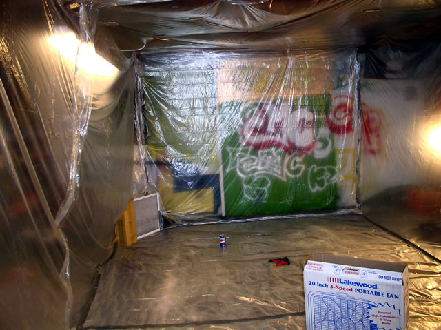

Today was a long day. I started by sanding the sideskirts, cleaning and sanding extensions and the spoiler and the front bumper, and then disassembling the mirrors and cleaning and sanding those. I also worked with the rear extensions and managed to get them to fit somewhat decently. The most time consuming part of the day however was building a home-made paint booth in my garage. First I cleared out an area. ![]() Then my mom and dad and I put down plastic for the floor and ceiling and north and south walls. ![]() Then we put in the east wall and the filter. ![]() Then we put a fan in, which sucks air out of the booth. ![]() Then finally we put in the west wall and I made a door and finished sealing it off. ![]() The idea is to get the overspray to flow upwards and out of the paint booth so it doesn't fall on the paint. I tested out the booth a few minutes ago though, and it just sucked the plastic walls in. I need to put weights on the floor on the outside to hold that down and probably put a fan blowing air in behind the filter. I'm going to do that tomorrow though, since I'm crazy tired. -------------------- New Toyota project coming soon...
