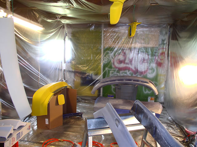

Today I got the paint booth to work reasonably well by setting up another fan behind the filter.
I then laid out parts and cleaned them again.
Then I painted. This is where it got bad. The gun I was using sucked and everything has tons of orange peel, and the rear bumper will have to be repainted because the gun malfunctioned and shot globs of paint everywhere. frown.gif
Below you can see the orange peel detail.

- - soulshadow   Coomer what gun are u using for your spraying and ...   Jun 4, 2006 - 9:24 PM
- - b1gr3d   if u got that much orange peel it was probably bec...   Jun 4, 2006 - 11:04 PM

- - doGGy   Check what Air pressure your Paint gun requers - i...   Jun 5, 2006 - 4:13 AM

- - doGGy   Chris - about orange peel - either you are using t...   Jun 29, 2006 - 9:41 AM

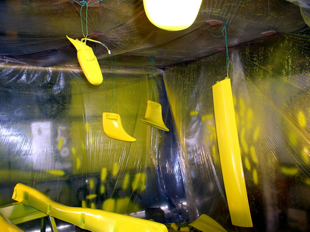

- - Coomer   Day Eight Today was a good day...I finally got th...   Jul 1, 2006 - 3:43 AM
- - JFrost9   What did you do to get the paint to work out? I t...   Jul 1, 2006 - 2:02 PM

- - Rayme   are you using a single coat type of paint? (uretha...   Jul 2, 2006 - 10:05 PM

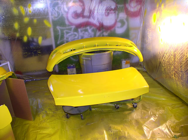

- - Coomer   Day Nine Day nine was tons of work, but I got a l...   Jul 3, 2006 - 8:43 PM
- - b1gr3d   QUOTE(Coomer @ Jul 3, 2006 - 7:43 PM...   Jul 3, 2006 - 10:30 PM

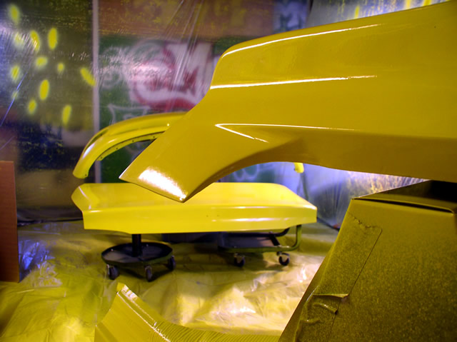

- - Coomer   Day Ten Today I painted the last of the parts off...   Jul 4, 2006 - 8:18 AM
- - Batman722   Coomer, I am so looking forward to seeing the fini...   Jul 4, 2006 - 11:36 AM
