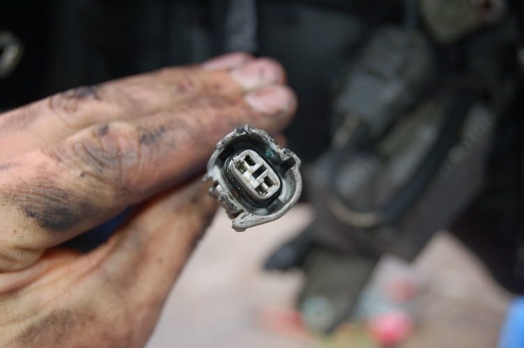

well after two days of an intense puzzle known as wiring.. i have all but one connecter identified and plugged in. It is at the driver side of the intake manifold and i cannot seem to locate the other place to hook it in. Im guessing its a sensor or something that i dont have but im not sure.. here are some pics:
![]() ![]() ALSO: what do i do about this oxygen sensor ? it is the lower of the two on the Down pipe:

ok im going to leave the dp temp sensor unplugged,
buttt here is my new problem, i have a grey connector that fits the same as the blue so i had it where the blue was supposed to be. in the process of removing the grey connector from the boost controller thing, i broke part of the boost controller thing.. what are my options (fast) for the broken part... can i leave it out? can i replace it with an aftermarket controller etc... also where does this grey connection go now!?! haha thanks for the help ![]() ![]() ![]() the wire colors for the grey one are: black with a yellow stripe and blue with a yellow stripe |
