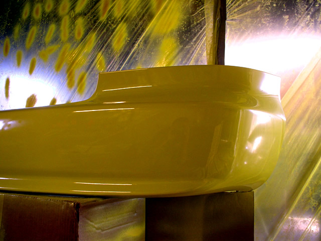

Day Eight
Today was a good day...I finally got the paint to apply correctly, and it looks great so far on the parts I've painted. biggrin.gif I sanded down the underside of my trunk lid so that I could test the paint on that.
I then cleaned it off and painted it, and it turned out well.
So I went ahead and painted the rear bumper, rear extensions, and fuel door, and all of them turned out good as well. biggrin.gif I'm so happy that I finally got my painted parts looking good. Tomorrow I'm hoping to get a lot more parts that are off the car painted. smile.gif

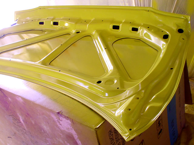

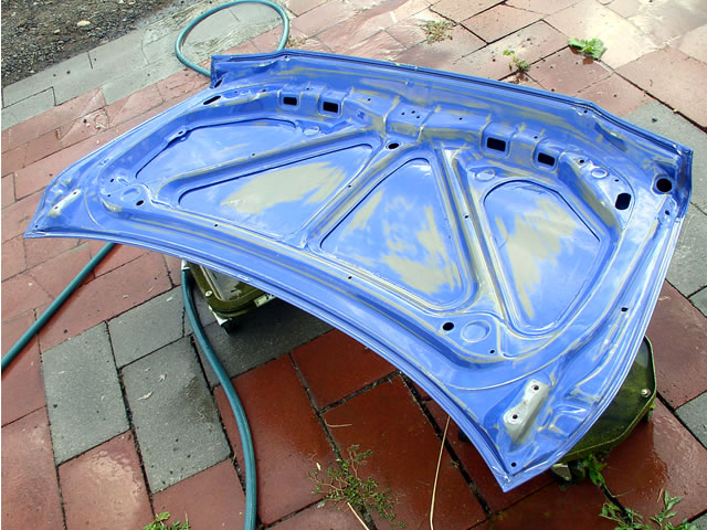

- - Coomer   Day Seven Today consisted of sanding everything d...   Jun 28, 2006 - 10:26 PM

- - Coomer   Day Eight Today was a good day...I finally got th...   Jul 1, 2006 - 3:43 AM

- - Coomer   Day Nine Day nine was tons of work, but I got a l...   Jul 3, 2006 - 8:43 PM
