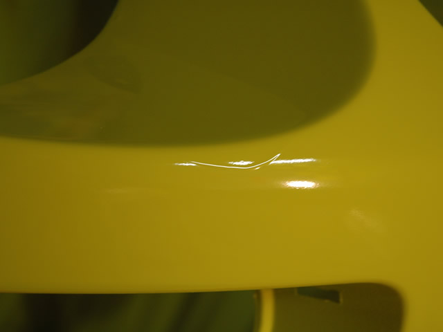

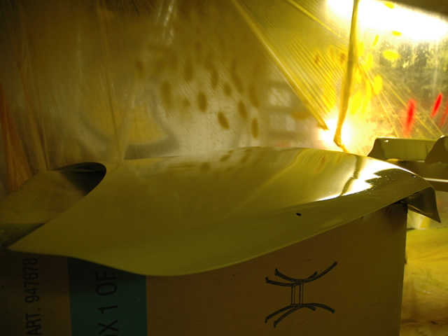

Day nine was tons of work, but I got a lot done. I sanded down my front extensions, sideskirts, and rear spoiler pieces since they were painted, and then I shot some parts.
For the most part, things went well. You can see most of the parts above.
I put too much paint on and got a run on the corner of the front bumper though. You can also see some orange peel.
The trunk lid had quite a bit of orange peel. Flat surfaces are hard for me to shoot. kindasad.gif

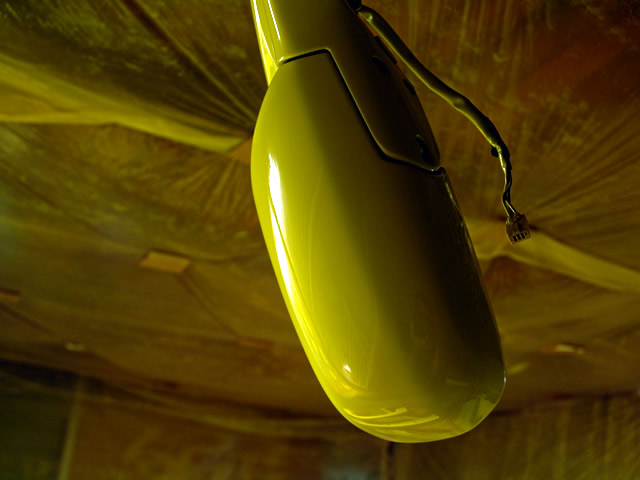

The mirrors turned out well too.
