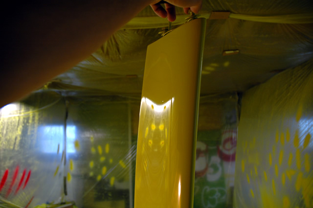

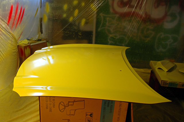

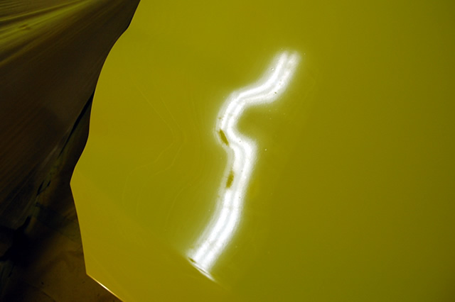

Day Ten
Today I painted the last of the parts off of the car. Again, I had trouble with the pieces with large horizontal surfaces getting lots of orange peel. kindasad.gif
In the photo above, you can kind of see the orange peel.
In this one, you can see it in closer detail.
The vertical pieces, like the spoiler posts and center section, came out well though.
