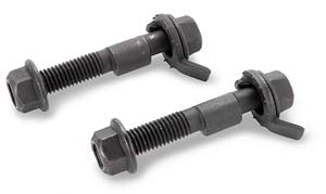

I have a 94 gt. Dropped with h&R springs and KYB shocks rear and front.
I took it to get alighned and they said because of the drop the camber is off slighly. I have the upper mount of the springs with a preset camber adjustment. Is there something else i can do to adjust it better. What do you guys have. Even after the alighnment the car still turns towards the right. -------------------- ![]() |

Just get the eibach or obx camber adjustment bolt...its basicly bolts with cams on them.
![]() Its what I have and my alignment is all in specs now(mind you I installed the bolt myself using my eyes as aligment! lucky sob). This post has been edited by Rayme: Jan 3, 2007 - 4:54 PM -------------------- ![]() -Rémy 02 SiR, 08 250R |

QUOTE(Rayme @ Jan 3, 2007 - 4:51 PM) [snapback]514878[/snapback] Just get the eibach or obx camber adjustment bolt...its basicly bolts with cams on them. ![]() Its what I have and my alignment is all in specs now(mind you I installed the bolt myself using my eyes as aligment! lucky sob). Thank you for the help. This is what I found I hope it works well. IEC-35450 Adjustable Camber Kit, Eccentric Bolts, 17mm, Toyota/Lexus/Pontiac/Scion, Front, ![]() Ingalls Engineering Co Not all camber kits are created equal! These adjustable camber kits from Ingalls Engineering have a Posi-Change feature, allowing camber changes up to 3 degrees positive. Each block displays a vertical line above the bushing that represents a 2 degree positive change. Don't trust your wheel alignment to just anyone--Ingalls has been producing camber kits for over 20 years, and you can be assured that you're getting a quality product -------------------- ![]() |
