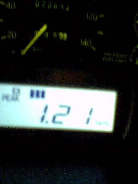

i was just out driving. ran into a dsm. similar situation to yours. my result was....
thats 1.21bar aka 17.5psi . it holds that just fine. so i don't think your problem was in anyway related to turning up the boost to just 10psi.

- - lagos   QUOTEThe s534 broke the day after I raised my boos...   Jan 26, 2007 - 7:01 PM

- - lagos   did you look inside to verify that the 5th gear sy...   Jan 26, 2007 - 10:34 PM
