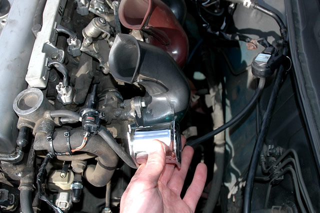

Before the weekend, my velocity stacks arrived, so I had to modify them to fit my intake manifold.
As you can see, the place where the holes were was cut, so that now there are notches. This was done because the holes didn't match the holes on my intake manifold, which are a little bit further apart than the velocity stacks.
I then bolted them on, loomed up the harness, cleaned up some vacuum line routing, installed the VVT plug and OEM Toyota coil (from a ST164 Celica with a 3S-GE,) and then hooked the battery back up. When all of this was done, the bay still wasn't complete, but it was clean enough to go for a drive.

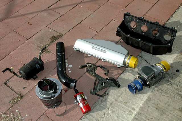

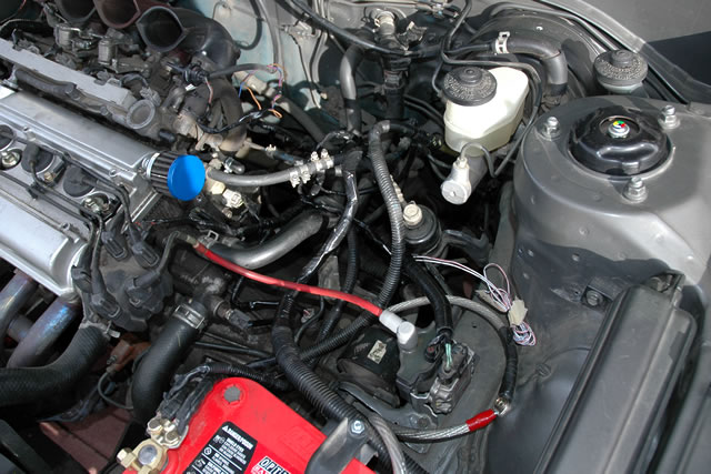

I do want my car to suck...massive amounts of air that is. wink.gif I've got some photos as promised.
And the ensuing mess that was previously hidden by the intake stuff.

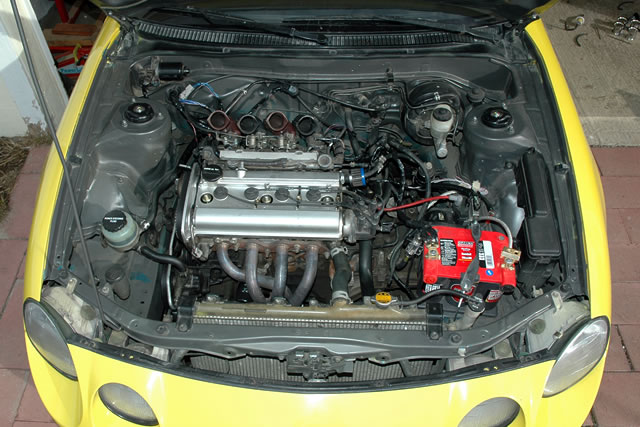

The engine bay, with the AE101 factory velocity stacks. When I finish the bay I'll paint them all black, and possibly get two more so they can all be the same.

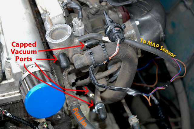

And finally, my working vacuum line setup. The little line with the screw in the end was the uncapped one that was hidden away and causing all my problems.
