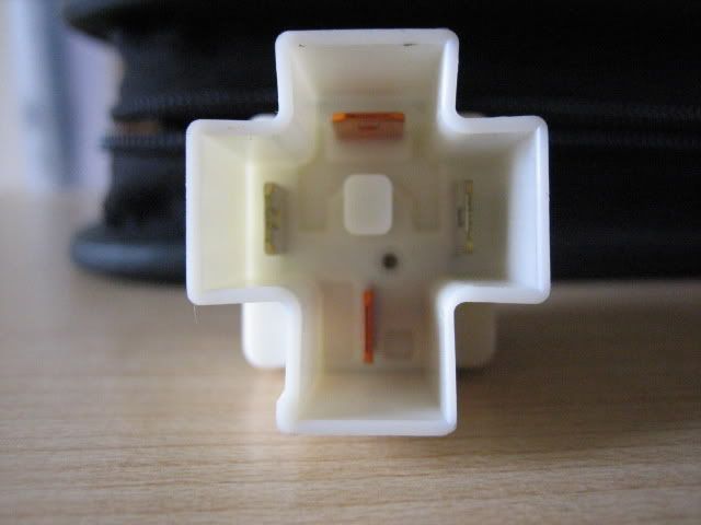

i pulled my efi relay. i'm supposed to be getting continuity across the blades as shown on top of the relay?
across the silver ones (horizontal in the picture above), right?

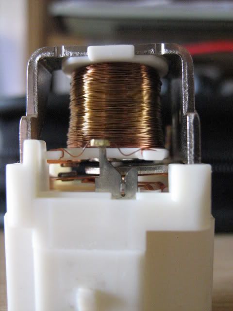

i read a resistance of 76 ohms across those terminals but the continuity buzzer reads "open".
i pulled the thing apart, and it looks pretty clean inside (no corrosion or anything)
i also pulled the starter fuse to check as a comparison (the starter is working fine) and i don't get continuity across the same terminals on that, either.
do you know who i am, mr. worley?
