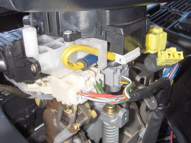

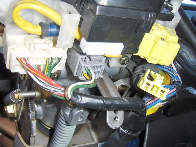

Funny that you should say that - Take a look at the pics below and you will see that the yellow cable connection is completely disconnected. Now I'm obviously no expert in Steering Column wiring but everytime I have seen a yellow cable or wires wrapped in yellow wire loom - that means airbag wiring. I first noticed this when I was installing various short shifter in various Celica's and MR2's. No matter what gen/model it was - yellow always means air bag [which to me means "DON'T TOUCH!!!"]. Further evidence of this can be found in the yellow cable behind the pass side low beams and high beams - that comes from the collisions sensors in the front bumper area [BTW - WTF is with all these people - overseas mainly - calling bumpers "bumbers"? - is some kind of inside joke?]. I think we've all seen the ones running past the shifter assembly, safely tucked in their own plastic guide/armour.

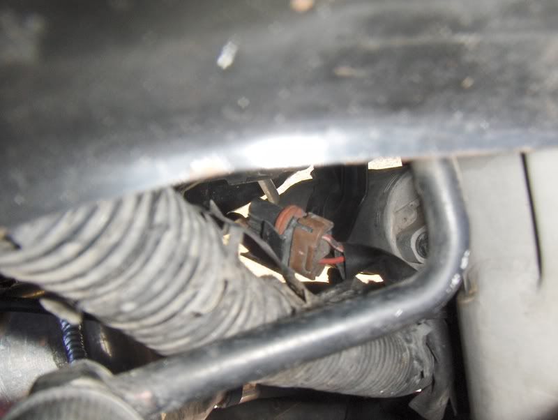

A little more history - when I got this car it had no pass airbag [which I'm cool with cause I have a killer idea what I'm gonna mount there - but that's a story for another day], no rear seat belts and no 5MPH crash bar so obviously safety was not a factor with one of the two previous owners [not talking smack on you guys - we all had our dream for this car]. And now I'm 99% sure the drivers side bag is disconnected as well. W/e - I can deal with it [they never go off anyway - I've had my last '99 spin off the road, fly over a 4' deep ditch and nosedive into the crest of the ditch on the other side causing 6K in damages to the front end and 3 of the knuckels - basically ripped the front two off and my drivers side rear had so much negative camber a drifter would say that's a little superfluous] Anywho - here are the pics: Underneath the naked steering column: ![]() from Pass side [Note the disconnected yellow plugs]: ![]() and from drivers side: ![]() And here is a view down into the space between the front bumper and the radiator upper support. To the right you can see the freon canister and all of this is directly behind the Drivers side high beam: ![]() see that loose connector? i suspect it was meant to hook up to another connector that had wires to the stock horn. This was were the connector was for my '99 except it had another one on the pass side cause it had dual horns. Does anyone know for sure if that what that is? It appears to have only a red wire and a red/white wire with grey dashes but I can ony see about an inch of it. Would this be the horn out put after the relay? And to let you know what I'm doing - I wired the new horn directly to the battery to a switch underneath the steering column and back to the front to the horn. I want to eliminate as much wiring as possible and I for sure don't want a ghetto setup where I gotta hit a switch to honk my horn. the horn switch works cause I can hear it click [my volts meter is at the casa so I want to get as many informed answers before get there and get stuck with no 6GC.net support. -------------------- ![]() ENGINE: '93 RC 3S-GTE/WRC CT-20b [18-20PSI] PERF: TRD/HKS/ARP/NGK/MSD/ACT/Blitz/STRI/APEX'i/TwosRus/GReddy/Magnaflo/KOYO SUSP: Tein/Bilstein/SusTech/ INT: SS-III SEATS/Toyota Hyper Sports EXT: WRC/TRD/404 Its a safety feature so that people like you don't end up killing themselves or everyone around them. Slow down Paul Walker. 6GC Chat - Go there: [url="http://www.griffgirl.com/forum/chat/index.php[/url] |

Batman722 for under the column, use the green wire from the ... Feb 11, 2008 - 9:55 AM
DEATH Thanks guys. The green wire shows constant voltage... Feb 11, 2008 - 10:22 AM![]() ![]() |
