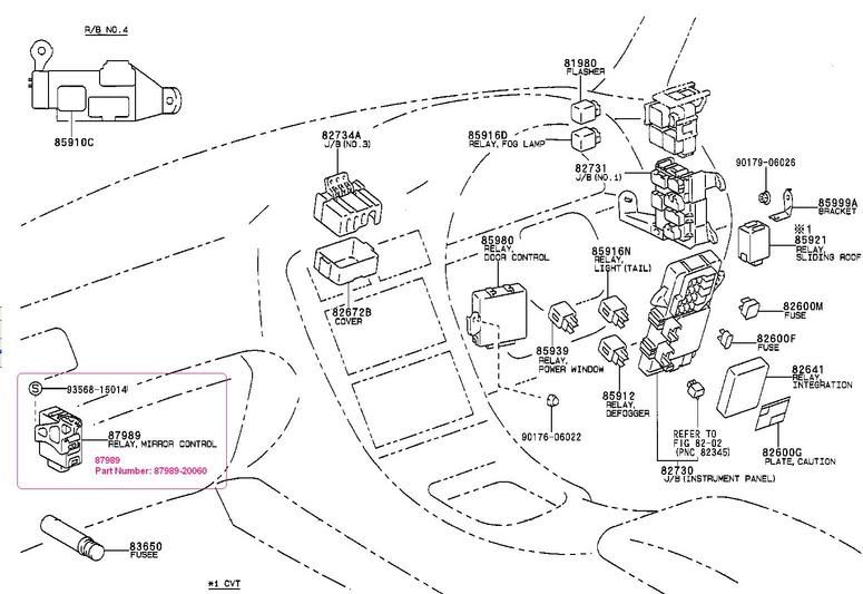

1) where is the factory location of the relay box? in the center console? below the driver pass? just for reference.

1.
however you'll be missing the bracket that's needed to mount the relay box to the body. you'll end up mounting it in a place that would make the install a bit easier (like in the driver-side beneath the steering column somewhere and ziptie it tight.)
