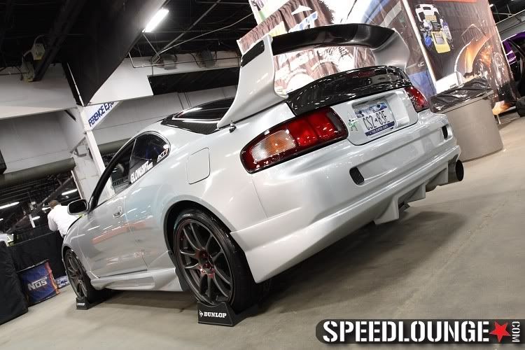

this is 18x8.5 with a +32 offset.
i believe this is the best width and offset. although i would do 17x8.5 +32 this guy says he does not rub and he is pretty low. if the ones you are looking at with a +38 offset do rub, you can always get a 5mm spacer.

this is 18x8.5 with a +32 offset. i believe this is the best width and offset. although i would do 17x8.5 +32 this guy says he does not rub and he is pretty low. if the ones you are looking at with a +38 offset do rub, you can always get a 5mm spacer. ![]() Hey I really like those. Any idea what kind of tires are those size wise? LOL That sounds funny, Size Wise. LOL -------------------- 91 MR2 Turbo SW20, 92 MR2 Turbo SW20, 95 Celica GT ST204

Promasta oh ya i forgot about that
they are 225/40/18 Dec 21, 2008 - 2:51 PM
