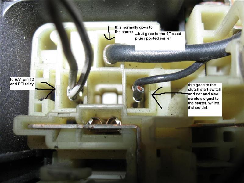

post Jan 5, 2009 - 8:39 AM
so here is a pic of what im talking about:
so, im planning on just wiring the 3s starter switch wire into that ST wire, like it should be.

- - presure2   so here is a pic of what im talking about: so, ...   Jan 5, 2009 - 8:39 AM
- - Dr_Tweak   Nice. So the starter was being powered directly ou...   Jan 5, 2009 - 10:05 AM
|- - presure2   QUOTE (Dr_Tweak @ Jan 5, 2009 - 10:0...   Jan 5, 2009 - 12:58 PM
- - lagos   But what about those two wires from the efi relay ...   Jan 5, 2009 - 1:36 PM
|- - presure2   QUOTE (lagos @ Jan 5, 2009 - 1:36 PM...   Jan 5, 2009 - 3:17 PM
