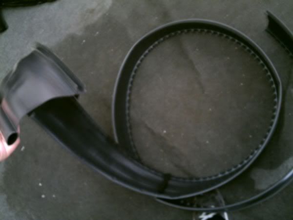

yay! i made a DIY home depot lip! since i don't like spending money on parts that don't have much function or would get torn off at rallyx events, i went the cheap route instead of spending good money on ss III splitters. i used some plastic lawn edging and personally i kinda like how it turned out for a ghetto piece.
in order to get it to mount up , i trimmed these edges off for a flat surface. after that i bent it, used a little butane torch to hold the bend. all i had to do was punch holes and zip tie the material to the bumper and fenders.
not bad for $8 in lawn edging (which there was still enough left to make at least one more) and some zip ties. i just like how it stupid slant chin look of the stock bumper.
