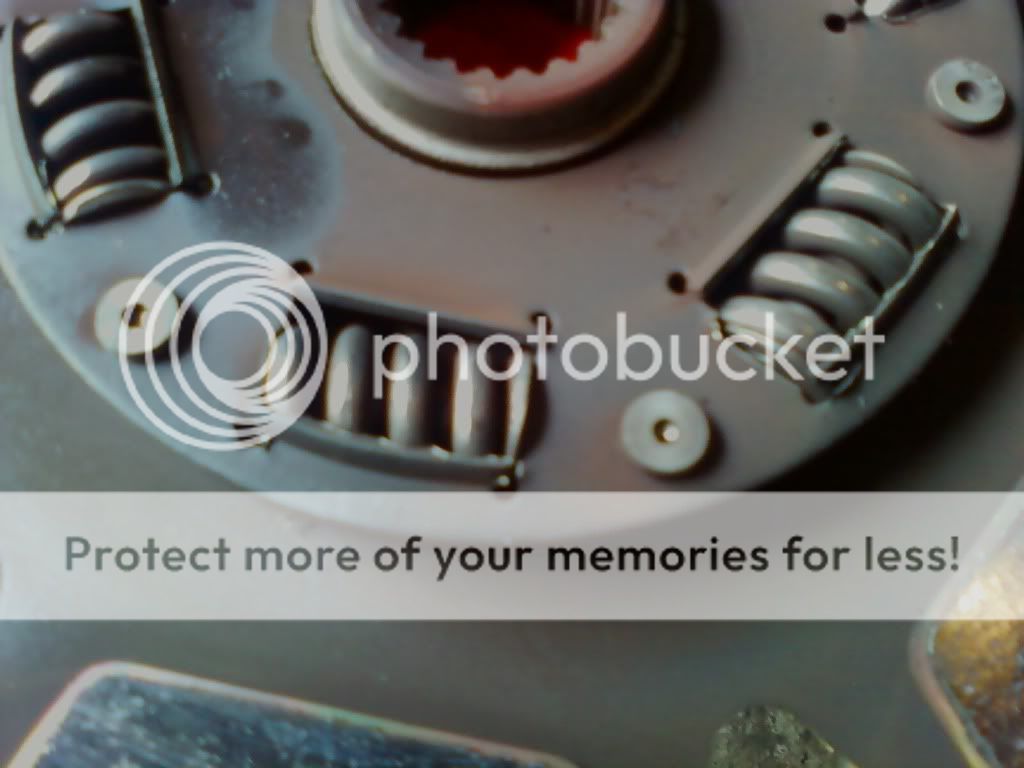

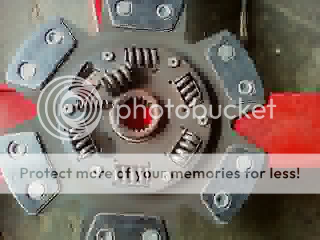

- - Darkchylde   long story short, got the tranny all out. all this...   Jun 16, 2010 - 8:12 PM
