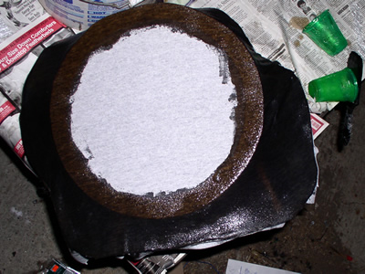

post Dec 28, 2003 - 8:24 PM
Just to update you guys, I held the MDF speaker ring on with wooden dowels and hot glue today, and then cut apart an old t-shirt and stretched that fabric on and then held it on with hot glue. I then applied a coating of resin and MEKP to the fabric and I'll let it sit overnight to harden. Here's my progress so far. smile.gif
