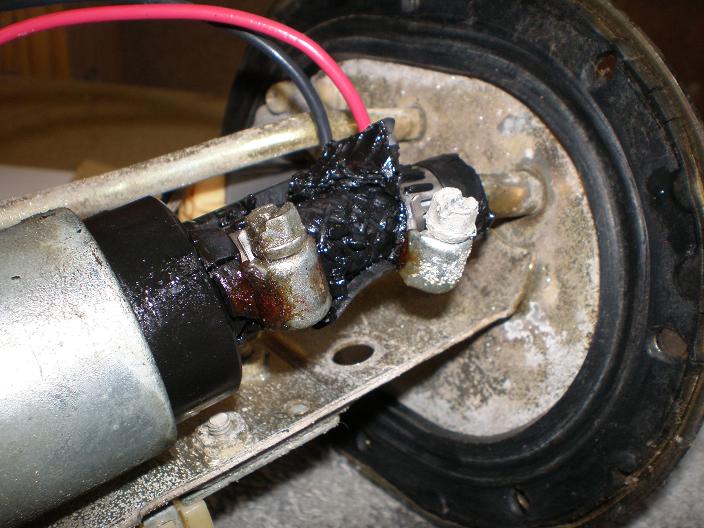

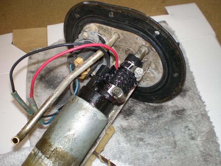

Thanks for your kind comments. After giving the fuel problem some more thought I was suspicious about the fuel pump installation. We pulled it out and found this:

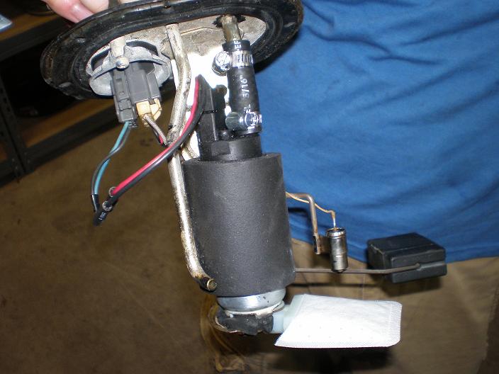

Looks like they used a piece of heater hose for the fuel line. For those that don't know, fuel and oil will eat right through a heater hose. So the pump was pushing a little bit of fuel up to the rail but not enough to open the regulator. We redid the fuel pump install...
And then after resuscitating the injectors, it started up on the first try smile.gif
