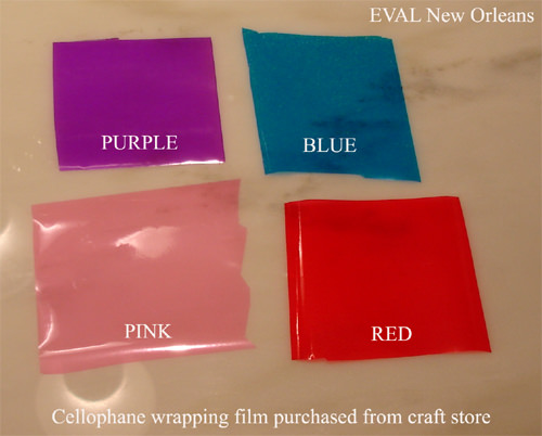

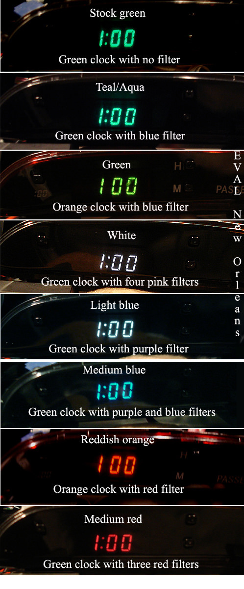

most of us have the green clock, so only those will work with us. i would have never thought to use purple and blue to have a blue clock. guess ill have to try it out.

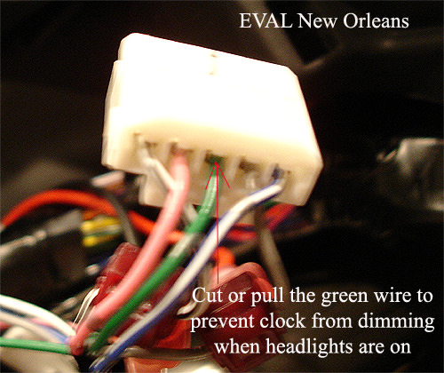

nope, our clocks are diff. wiring. they only have four wires, but cutting the green wire still stops it dimming when your headlights come on.

QUOTE (ShadowFX @ Apr 5, 2005 - 1:14 PM) *
You don't have to cut anything to stop dimming. Open the clock and remove spring which makes electrical connection between PCB and green wire.
- rocky2006   pretty cool clock color guide   Mar 27, 2005 - 1:29 AM
- - CelicaSTX02   what do they mean by "filters"......how ...   Mar 27, 2005 - 1:54 AM
- - rocky2006   oop, my bad: http://www.everythingcelica.com/gal3...   Mar 27, 2005 - 1:58 AM
- - ShadowFX   where is the plug thats in the third pic? just the...   Mar 27, 2005 - 7:13 AM
- - rocky2006   i guess so. ill see if i can get to doing this to...   Mar 27, 2005 - 12:07 PM
- - Drocay   are clocks aren't that complicated, u just tak...   Mar 27, 2005 - 8:48 PM
- - rocky2006   my click is teal with the filter off, which is why...   Mar 27, 2005 - 9:10 PM
- - Drocay   it must change from model to model then i did mine...   Mar 27, 2005 - 9:16 PM
- - ShadowFX   yeah mine is a light green/teal without the brown ...   Mar 27, 2005 - 9:55 PM

- - ArizonaRed   Its friggin easy just buy some celophane or tabs l...   Mar 28, 2005 - 11:35 PM
- - blaque_6thGen   Unfortunately I have the brown lens. This makes i...   Mar 29, 2005 - 12:23 AM
- - Batman722   I am gonna give it a try and disconnect my wire to...   Mar 29, 2005 - 12:41 AM
- - rocky2006   blaque, you take the lens off. you dont keep it o...   Mar 29, 2005 - 11:17 AM
- - rocky2006   i just did it. its much better than the teal i ha...   Mar 29, 2005 - 2:20 PM
- - Batman722   I just cut my wire. It works perfect. No more dimm...   Mar 29, 2005 - 2:27 PM

- - ShadowFX   just cut the green wire? does your plug look like ...   Mar 30, 2005 - 4:48 AM

- - Batman722   QUOTE(ShadowFX @ Mar 30, 2005 - 4:48 AM)just ...   Mar 30, 2005 - 1:05 PM
- - ShadowFX   ok thanks batman. i dont want to go cutting any wi...   Mar 31, 2005 - 3:17 AM
- - Hanyo   i wonder what year celica gets the white clock? i...   Mar 31, 2005 - 3:18 PM
- - rocky2006   that was the point of this thread haha. for those...   Mar 31, 2005 - 4:21 PM
- - JoKeRkId613   maybe this is a dumb question. what kind of clock ...   Mar 31, 2005 - 10:59 PM
- - rocky2006   all clocks have filters. mine was a teal clock wi...   Mar 31, 2005 - 11:13 PM
- - Drocay   mine was White with Brown filter.   Mar 31, 2005 - 11:44 PM
- - gt2nv   i think that some of the wiring that is back there...   Apr 4, 2005 - 8:54 AM
- - ShadowFX   nope, our clocks are diff. wiring. they only have ...   Apr 5, 2005 - 5:14 AM

- - CaliJeff   there is only 4 wires. cut the green one. right ne...   Jul 6, 2007 - 12:45 PM
- - jason   if you dont wanna cut it.. just pull it outta the ...   Jul 6, 2007 - 5:13 PM

- - xs94st   yea..any1 know what kind of things to layer on top...   Oct 10, 2007 - 1:27 PM
- - kerosene   what color are you aiming at?   Oct 10, 2007 - 11:22 PM
- - xs94st   well, rite now its the teal / bright greenish. i w...   Oct 11, 2007 - 2:27 AM

- - WWSideWinder   Old Thread but worth an Update. Super Gel Sample...   Nov 8, 2008 - 3:38 PM

- - andreslr   Hey guys, just to update this. I found a rosco di...   Jan 13, 2010 - 1:04 AM
- - Arsaces   I just went to a rosco dealer in jacksonville. The...   Jul 5, 2011 - 4:47 PM
