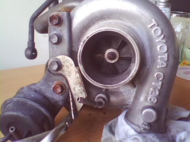

this is what we call an upgraded ct26 or a ct26/t04e hybrid turbo
it's a ct26 housing, both sides, the compressor housing is machined to accept a t04e 46mm compressor, this is fitted to the shaft and whole rotating assembly balanced on a machine, and then shoved back into the 185 turbo. An ST205 10psi actuator is added and away u go.
The end result is really crap compared to a ct20b. (my fault for assuming ATS does it the same way)

- - delusionz   this is what we call an upgraded ct26 or a ct26/t0...   May 8, 2011 - 10:23 PM
- - delusionz   I found another pic of a T04e upgraded CT26 which ...   May 9, 2011 - 4:37 AM
