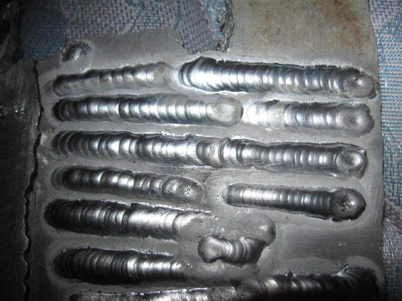

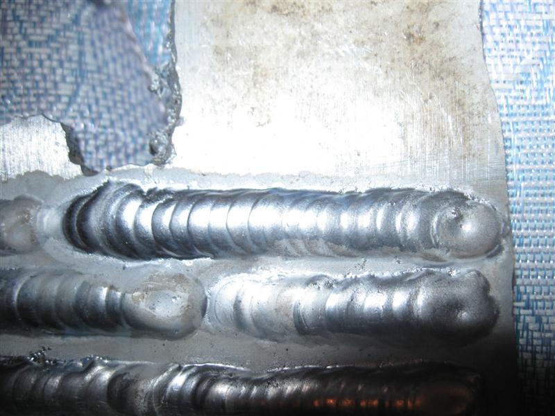

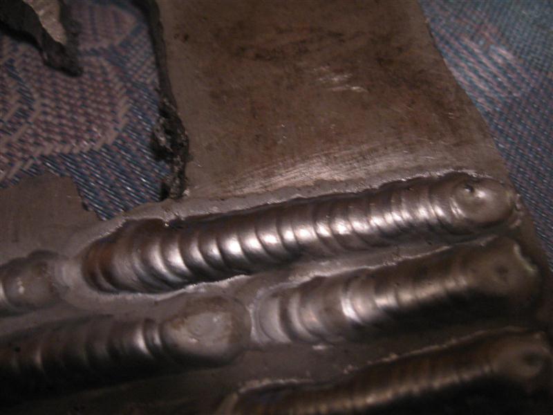

got more practice in today, another hr or so, starting to get a little more consistant and co-ordinated with both hands, i think once i get some extra cash to either build a welding table, or at least get one of those portable "nomad" welding table like jody uses, it will really help, right now im welding on a wood topped bench thats way to high for me, with a peice of 3/8" steel laying on top that i use as a ground point/heat sink
so settings are as follows:
3/16" aluminum diamond plate (welding on the backside)
3/32" 2% thoriated tungsten, ground to a dull point
3/23" 4043 filler rod
160amps max footpedal controlled
a/c frequency @ ~125
a/c balance @ ~ 40%
a few pics:
the first is the overall pratice, the last couple are my best bead so far.
got a little hot there right at the beginning, started working the pedal back a little late.
still need some work filling that crater there at the end, i gotta work on putting in that little bit of extra filler as i work the pedal more.
getting there!!
