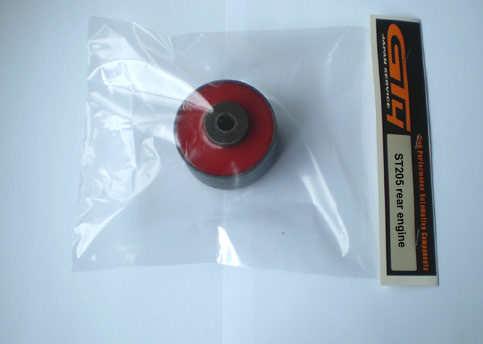

Hey everyone,
first of I have done a little research on where to get some and such, but I just want more solid info on getting some. I have a 3S-GTE (3rd gen) with an E-153 LSD transmission. so what I need are ST205 mounts. now the only ones I have found so far are just the front and rear inserts. I've seen some that look like they are molded to fit the inside of the mount and wrap the existing rubber in the mount, some that are just solid inserts and one set that look like the replace the inside of the mount entirely. so a few questions, are there side poly mounts? from experience, what are the best style of mounts? where do you suggest buying them? Thanks for your time, Kevin |

For the engine mounts you would have to cut out the rubber. Then take the same saw you used to cut the rubber and then cut a little slit out of the metal ring inside the mount, and knock it out or pry it out with a flathead.
There are 2 mounts available for the ST205 ![]() from the link i provided above ![]() http://speed-source.net/?wpsc-product=toyota-engine-mounts both can be installed with a bench press. The lower one probably wont really need one. Simple as that -------------------- ![]() 1995 GT::::Diffusing the Situation エキサイティングカーレーシングチーム! march 2010 COTM : 6GC feature 2014 : january 2015-2016-2018 COTM |
