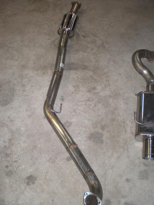

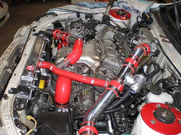

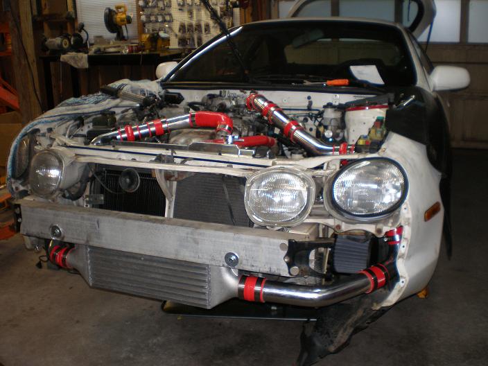

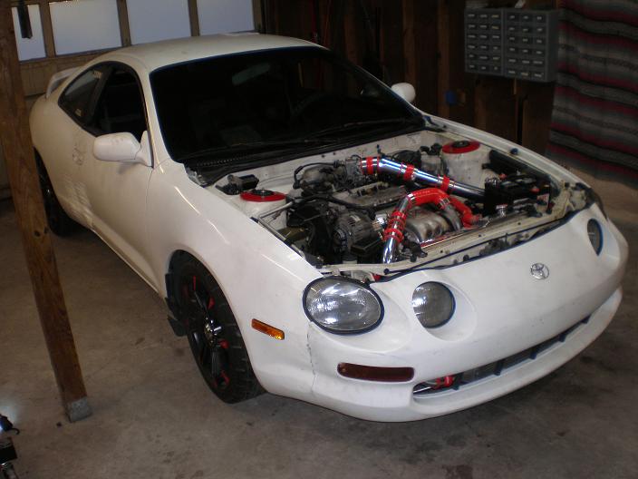

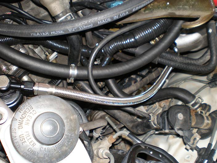

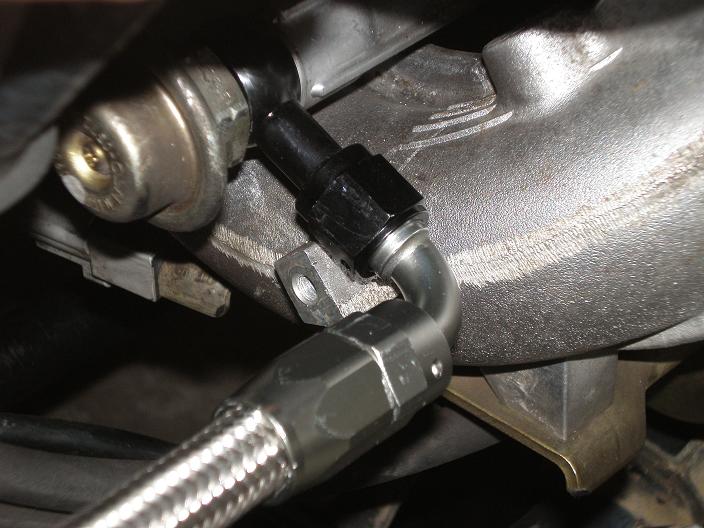

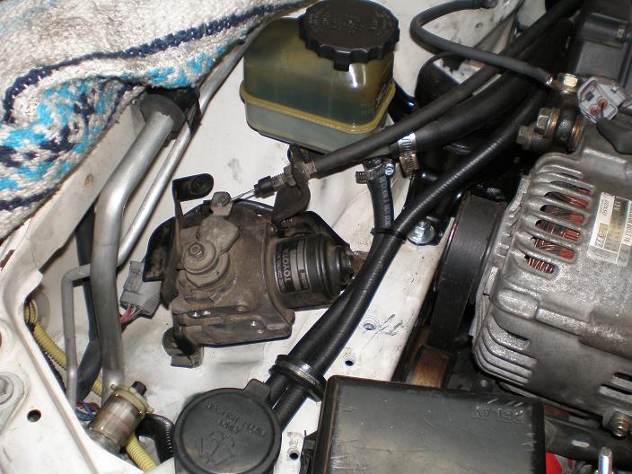

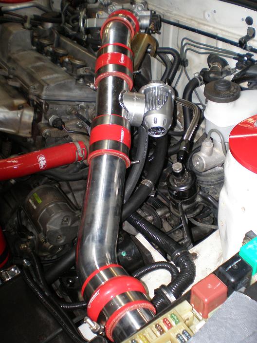

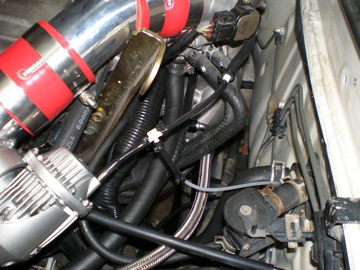

Sorry for not updating the thread, here are all the other pics of the swap, which is now complete.

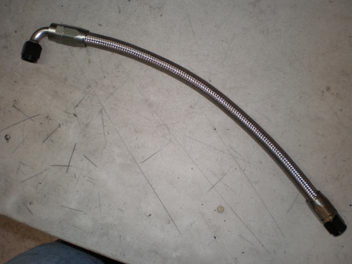

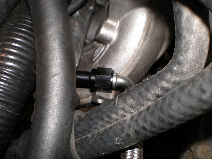

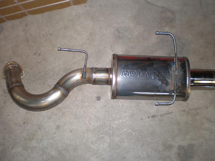

Stainless fuel line:

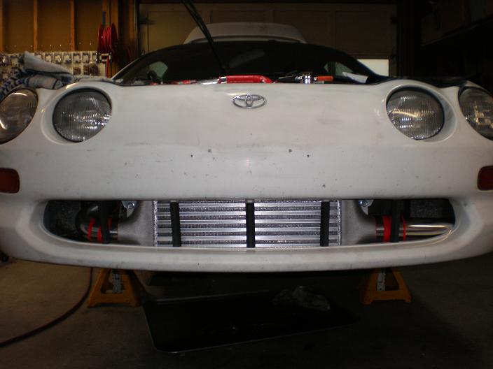

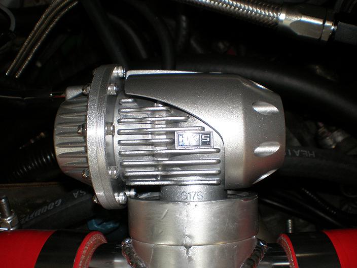

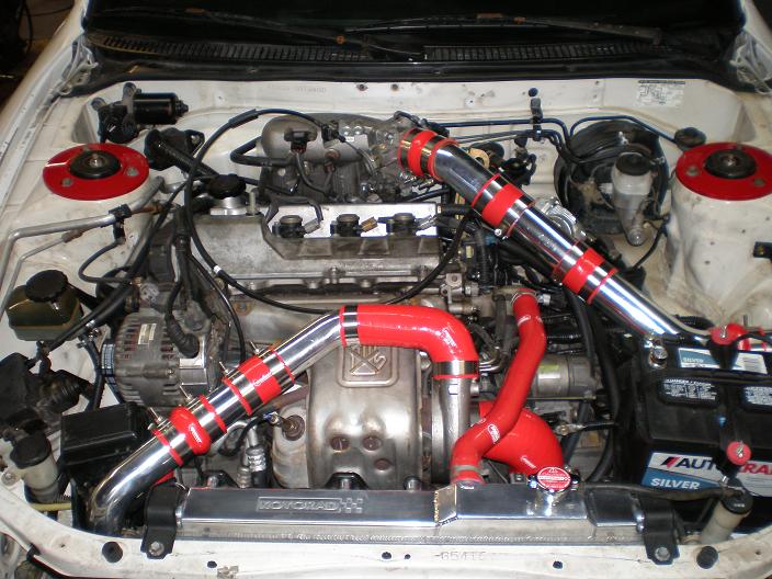

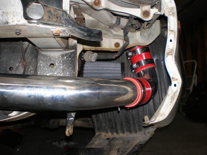

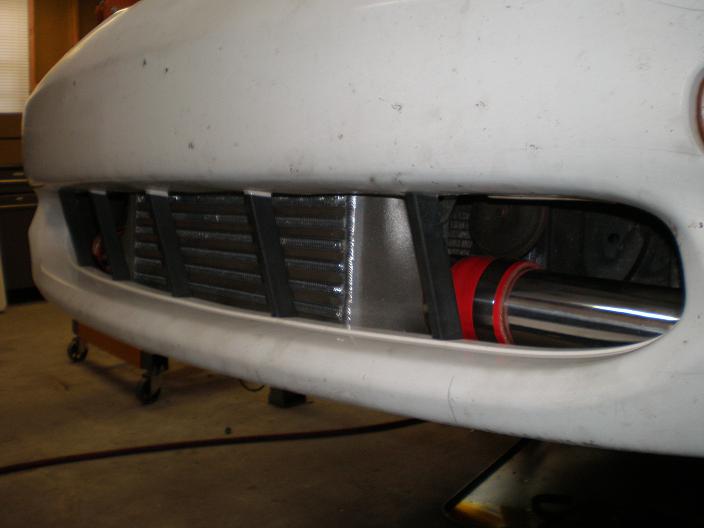

Intercooler kit:
Throttle cable and cruise control

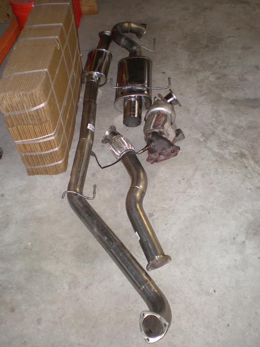

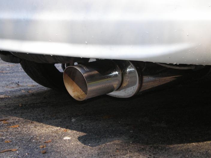

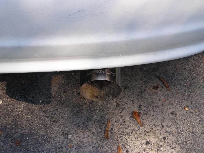

3" Mandrel-bent Stainless Exhaust

Looks great as always thumbsup.gif . Any way you could PM me a list of the Samco couplers/hoses you used? I need to begin purchasing mine.

If you want to send me an email I'll get you a price on putting a complete package together for you. contact@tweakdperformance.com

I normally dont like fmic setups but this one is beautiful!

tweak are you willing to make me one of those stainless lines?
I have that same magnaflow muffler. Thing sounds amazing!

which AC/PS lines were used?
well, the pressure hose from the steering rack to be specific.
stock ST power steering lines fit the 3s pump?

Surprising enough it did fit, yes.

AC lines too?
post Oct 28, 2010 - 2:18 PM
Dr_Tweak
Joined Mar 31, '04
From Summerville, SC
A/C lines took a bit of careful bending, but with a little creativity they did indeed work. Be sure to set aside several hours of labor for the work on the a/c lines, it's a bit of trial and error and you don't want to overdo it wink.gif

QUOTE (Dr_Tweak @ Oct 28, 2010 - 3:18 PM) *
That's surprising.
I have the rhd connections from the 3sgte compressor. Don't know if they would hook up to my current AC lines.
Did you use any bending tools? or just bend (and hope it doesn't crease) method.

Hey Doc, you know i admire your work, question for you. why dont you clock the turbo down so you dont have pipes going up and over the manifold?

QUOTE (purplegt4 @ Oct 28, 2010 - 3:32 PM) *
That's surprising.
Sorry, I forgot one important part of that. You need to swap the "manifold" from the top of the 7A compressor over to the 3SGTE compressor, THEN the 7A lines will connect, with a little bending. We didn't have to use any tools for the bending work, you just need to go a little at a time and spread the bend over a longer distance so that they don't kink.
QUOTE (Smaay @ Oct 30, 2010 - 1:25 PM) *
Back in the day we used to clock the turbos, but we stopped doing it for a number of reasons.
For one, getting a bracket made that will hold the wastegate actuator in the right place reliably takes an entire day of work (it's a lot of trial and error and most of you know how hard it is to take the turbo off a 3S).
You really don't gain much in terms of reducing the bends, especially the way that we route the piping now.
Fitting the intercooler piping between the downpipe and radiator fan is difficult or impossible if you have the factory downpipe (which we do).
Since the piping that goes past the manifold is on the hot side anyway, the intercooler does a great job of chilling the air and so temperature really isn't a concern.
Some of these things are contrary to what you may have heard from me in years past, but time and experience have mended my ways :-D The 90-degree coupling coming off the compressor outlet is simple, reliable, quick, and it works perfectly every time.
