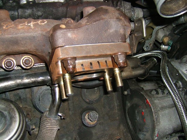

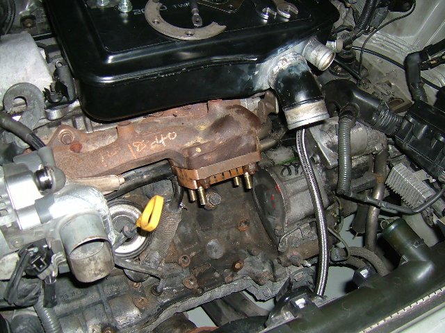

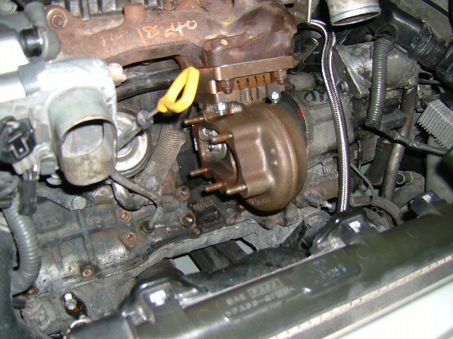

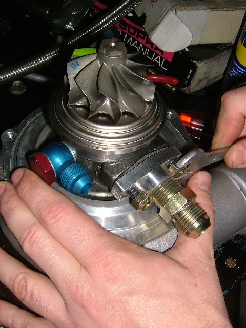

Ofcourse we started with getting rid of the old turbo (that was the start of all this, cos i blew off the wastegate of my stock turbo, that used to run on 1.25bar, which was just a little too much i guess). After removing the old turbo and trying to fit the new turbo, it turned out my aussie downpipe could not be used anymore, so we had make a new one, custom. We also had to replace the intercooler connection piece to the turbo. After all this was done, we could put on the turbo.

And to measure exhaust temperature, we made a hole in the adapter plate between the exhaust manifold and the turbo, so the exhaust temp is measured at the very best spot, right out of the engine, but not cooled down yet by the turbo or actual exhaust. This will of course be connected to the Apex'i gauge inside the car later on.
