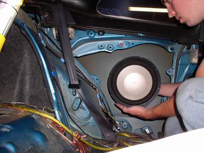

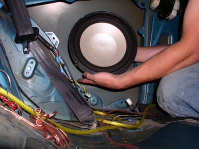

Yep, you could put a sub back there...a ten would fit...an eight would be easier. The photos below are my Infinity Reference 10" sub held up where I planned on putting it.

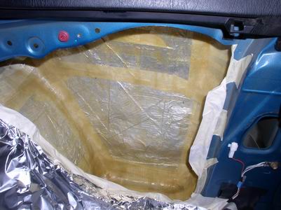

And I 'glassed the first couple layers of the enclosure...
...but then gave up on the project.

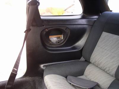

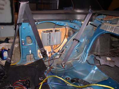

I don't think there's much of a difference in the hatch, but I'd pull off your panel just to be sure before you begin the project.
I was going to enclose the sub in a sealed enclosure that would stick through a hole I'd cut in the side panel.
I stopped because I realized that it was going to be a ton of work to do it the way I wanted, and I didn't have time.

wait coomer, you put your amp where the old speaker use to be. is there room left to put the stock speaker back in?
post Nov 21, 2004 - 8:46 PM
QUOTE(Hanyo @ Nov 21, 2004 - 5:22 PM)
[right][snapback]209967[/snapback][/right]
Nope, there's no more room back there for speakers...I tore the rear speakers out years ago, because I don't like rear fill at all. wink.gif

Do you think theres enough space in there to put a 10" sub in with no holes to the stock panel.
post Nov 22, 2004 - 4:54 PM
QUOTE(urbandork @ Nov 22, 2004 - 1:28 PM)
[right][snapback]210484[/snapback][/right]
Yes, it could be done with a shallow depth sub such as Pioneer's new one or something. However, you'd need a hole in the panel or tons and tons of sound deadening and stiffening for that back panel, because it would rattle so badly with a sub enclosed inside it. wink.gif
