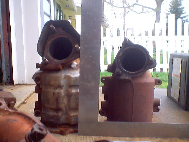

Here is a picture of a MR2 cat and alltrac cat side by side (smaller is MR2):
It seems to me that this would effect where the midpipe hooks up. If so, and my midpipe was custom fabricated for the MR2 cat, I think buying a MR2 downpipe makes sense.
That said, Doge used the KO downpipe made for the MR2 and got it to work. He said there was a little effort needed but perhaps even if they don't match up perfectly, you can get it to work with a little effort.

where did you get that pic from and are you sure its not a 1st gen or maby 3rd gen cat? there is also another piece of that DP that the pic dosnt show...so the whole thing might still be the same size.
i know a friend of mine that had a jdm st185 in his alltrac. his motor died and he swaped in a jdm mr2 motor. he said the downpipes were the same and his exhaust ligned up prefect.

actually, i've seen that pic on the MR2 boards. He's right, it is a bit different.
