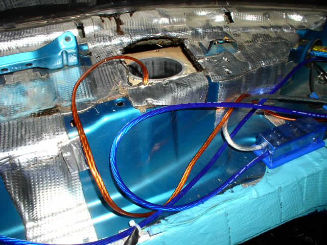

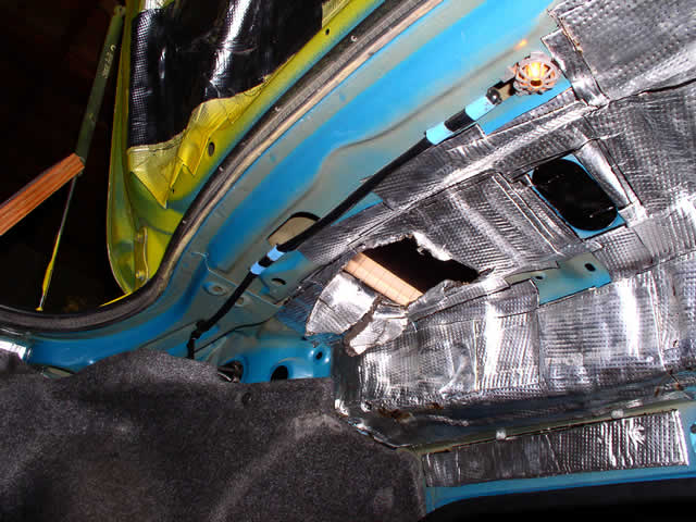

Then I cut the hole where I planned for my vent to be. I used a sawzall, which was no easy task due to the large size of the sawzall and the small working dimensions inside the trunk and cabin of the car.

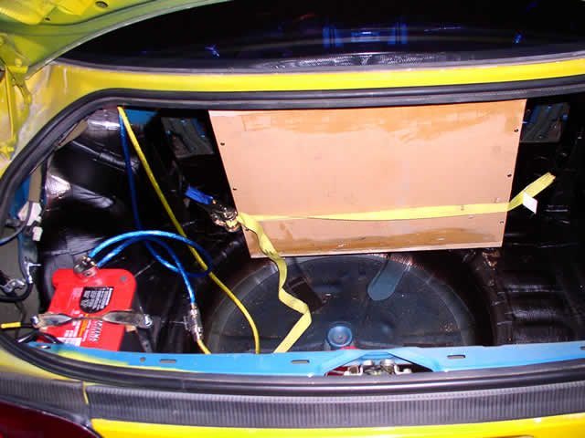

I then built the box out of .75" MDF...no pics of the build process, but you can see it above inside the trunk, un-carpeted, and held in by a tow-strap for testing purposes. That battery mount and cable setup is temporary as well, for testing purposes. wink.gif

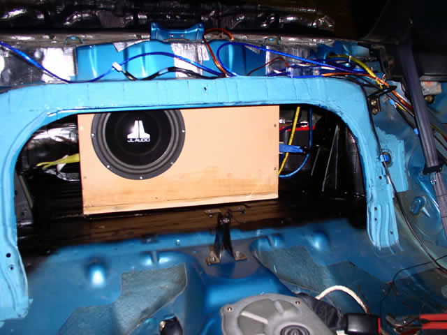

There it is from the inside of the car. I chose to point the sub towards the backseats, because it protects the sub from stuff flying around in my trunk.
"But Coomer, subs always sound bad when they're firing towards the backseats in Celica coupes."
They often do in a sealed box, but this isn't a sealed box. Due to the nature of a vented box, most of the air is moved by the vent, rather than the outside surface of the sub, so although the sub moves some, it doesn't produce enough output going forward to rattle the thin metal behind the backseat and make it sound bad.
Bad pic, but you can see the vent in the box pointing through the hole in the rear deck. The vent is simply 3"(inner diameter) PVC pipe, 14" long. I had to cut the pipe down 2"(from 16") in order to get it to fit in the car, so it raised the tuning frequency to 34 hz. Note that the number of inches removed from a port does not equal the number of hz raised in most cases...it just happens to in my case.

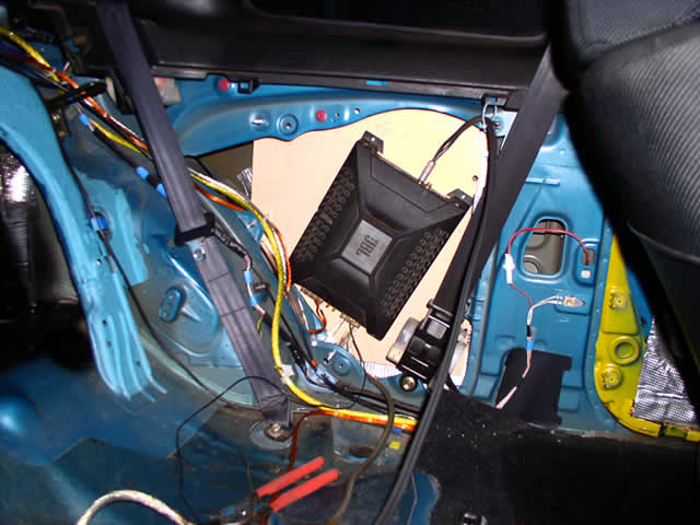

While I was at it, I figured I'd relocate the JBL BP300.1 that provides an estimated 225 watts to the 10W6. I know, it's a bad choice of a box for this amp, because the amp has no subsonic filter. I'll just be careful, and if the sub blows, at least I'm only out the $30 that I paid for the sub. Anyway, the amp used to sit on top of my old sealed box, but now it'll be hidden away behind that side panel. On the other side of the car, my amp for my front stage sits behind the other side panel.
