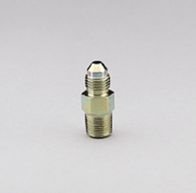

now the next thing is the oil feed line, and what to use for it.
the line for the oil feed should be no larger than -3an (3/16") alot of people have used re-enforced rubber hose for this, but IMO its one of those things where it just makes sense to spend the money to do it right to avoid problems later on.
www.atpturbo.com will custom make you a pre assembled -3an line with whatever ends you need, (1 straight, 1 90 degree)you want it to be ~16-18" long, tops. for ~ 40$ shipped. it looks like this:
then you just buy 2 STEEL -3an to 1/8"npt fittings, they looks like this:
you can get them from www.summitracing.com for under 3$ ea +shipping. the PT # is EAR961603ERL
use one for the head fitting i talked about earlier, and take the other fitting, and the stock oil line to you local machine shop, and have them cut the banjo bolt off the stock line, and weld the fitting onto it. heres a few pics of what i am talking about.

with that setup, you can pretty much forget about it, once its been run and know theres no leaks.
