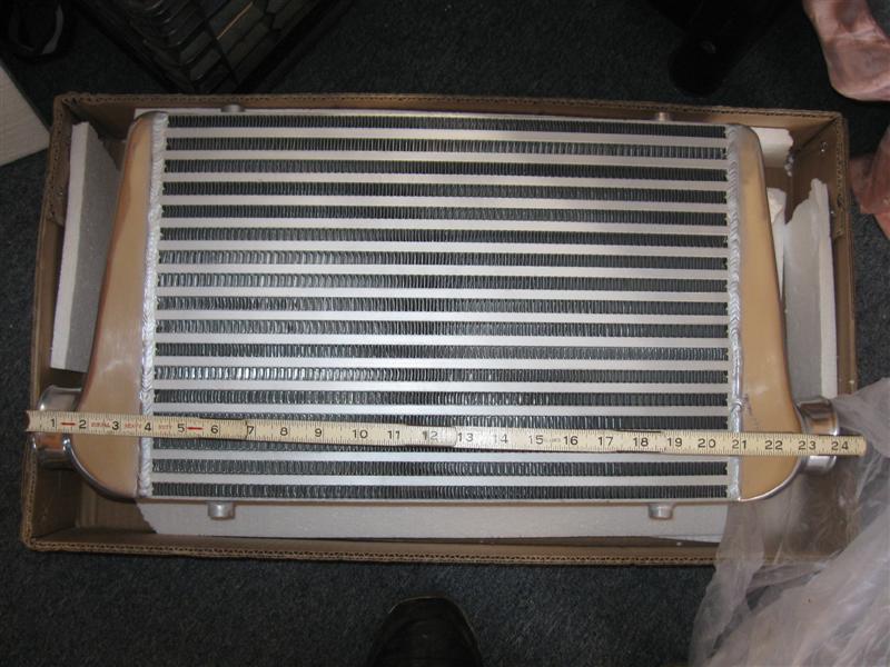

next for me was the intercooler..now contrary to popular belief, bigger IS NOT always better when it comes to intercoolers.
you wanna choose the smallest intercooler to fit your needs, with a LITTLE room for growth. for instance, in my case, my goal is around 190-200whp for now, so i chose a intercooler thats 26x6x3 overall length, with endtanks. its good for up to 300hp. why not somthing bigger? well, the #1 reason is theres no NEED for anything bigger. lol the bigger you go, the more pressure drop you have, and thats not what we want. with all the piping invloved for a 5sfte FMIC, the last then we want is some big honking core, sucking up 2-3 or more psi of the boost we wanna get to our engines.
