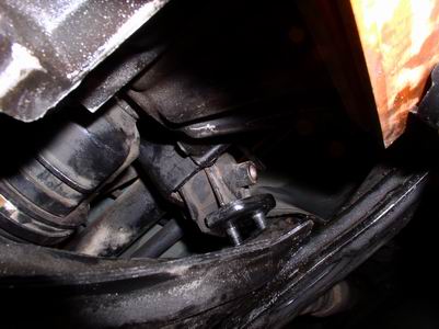

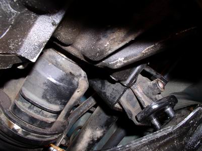

I'm trying to change crossmembers in my Celi, but now I'm horribly stuck after trying to get the crossmember out for a good couple hours.
I got the bolts out of the front and rear mounts, and loosened up everything on the crossmember. In the attempt to get the rear tranny mount to move up so that the bolts on it would clear the crossmember, the mount got twisted sideways and is now completely stuck. I tried everything, but nothing seems to work to get it loose. Here's some pics: Anyone got any ideas? By the way, if my new crossmember and mounts don't bolt up, I think I'm gonna torch the Yelli Celi. I absolutely HATE the mechanical aspect of working on cars.

I'd say to loosen another mount, or take another off, and then lift the engine with a jack. Keep pulling of mounts and lifting the engine till it frees up. Good luck man.

put a floor jack under the tranny and jack it up. that should give you more room to move that mount...
if that dont work. then you will need to unbolt the other crossmember (the one that geos left to right) to give more room for that mount to come out. -------------------- 15PSI - 30MPG - Megasquirt Tuned

coomer, looking at your pic again... it seems like you are just trying to take the mount out. that aint going to happen. you have to unblot the front mount and and the 2 bolts (12mm i think) that connect the crossmember to the front of the car. then loosen the rear mount (like you did in the pic) and take the whole bar out with the mount on it. use a jack under the tranny if you need to create more room. just remember to have the left and right motor mounts on the car.
if that still dosnt work, then have to drop the 2nd crossmember that the mount rests on.. its about 4 bolts on each side. make sure you have a floor jack under it, so that you can control how far down it drops. its very heavy and if you get it off center, it can be a bitch to lign up correctly. This post has been edited by lagos: Apr 4, 2005 - 1:22 PM -------------------- 15PSI - 30MPG - Megasquirt Tuned

Whats happening is the mount is being seperated, the rubber and the actual mount. I suggested take the mount off the tranny, or at least take 1 bolt off the tranny so that it can swivel. I think he's got it jacked up pretty far already.

I already took off the front two bolts on the crossmember and was manuvering it around attempting to get it out, but it can't possible come out with the rubber part of the mount still attached to it, because it can't move forward far enough to clear the mount bracket which bolts to the tranny. I had the crossmember so close to being free of the mount(one end of one bolt was probably stuck in the hole by a couple mm), but couldn't get it out. So we tried manuvering it more and that didn't work. Then I unbolted the top tranny mount and jacked the tranny up a bit. Then we tried manuvering the mount and got it stuck. At this point, even if I could get the crossmember out, I've still got the rubber part of the mount stuck inside the bracket, and I can't figure out a way to get it out of there. And no, I don't have an engine hoist. This post has been edited by Coomer: Apr 4, 2005 - 2:03 PM -------------------- New Toyota project coming soon...

I decided that since we broke the rear mount attempting to manuever it out, I'd just cut off the bolts on the mount.
So I busted out the sawzall. Then I got to work under the car...after a few minutes I had the mount and crossmember out. Here's the remains of the mount.
