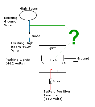

post Apr 10, 2005 - 2:39 AM
There's a quick diagram of how you'd wire this up.
The only part I'm unsure of is where there's the big green question mark. I believe that you'd use some sort of resistor, but the resistor I tried didn't work for when I attempted to do similar to this. Up in Canada they probably have more information on how to add DRL systems to cars...you could probably find the correct resistor at a junkyard.
post Apr 10, 2005 - 2:51 PM
Snarfer
Joined Dec 2, '03
From Virginia
The problem would be the resistor, you can't efficiently reduce the power of a light with a DC system. To half the power of the light you need to dissipate the rest of the energy in the resistor. So for a 60W rated bulb on 12VDC you will need a .996Ohm 12.4W rated resistor, when most electronic resistors are 1/4W.

Well I found this module that I'm thinking about buying instead of trying to figure it out myself. $30 isn't that bad. I'm not sure if this would work through the high beams though (not sure if it would leave the highs on at 1/2 power even when I switched the headlights to on, but that might be cool anyways).
post Apr 10, 2005 - 8:34 PM
I don't know why I didn't think of that. Yes, that would work prefectly with any lights you hook it to.
