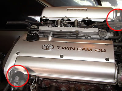

Tonight or tomorrow I'm going to try to get a hoist from a friend for the weekend and attempt to pull my engine to the point where it will move around so that I can get the rear mount in.
To do this, I need the engine to be free of all the mounts so it can twist just a bit. Now here's my question. First I'll show the pic. Can I simply attach chains to those two brackets to support the engine and move it around a bit while I get the mount in?

orvillescelica im 75% sure that you just use the two engine hange... Apr 8, 2005 - 6:45 PM
macavely u could use those... but those can also bend if so... Apr 8, 2005 - 6:47 PM
lagos coomer, yes those are the 2 hooks for taking an en... Apr 8, 2005 - 7:14 PM
Kwanza26 Yes... what lagos said. They're specifically ... Apr 8, 2005 - 8:12 PM
Coomer The horizontal crossmember on my car can't go ... Apr 8, 2005 - 10:11 PM

Snarfer You might be able to get away with just removing t... Apr 10, 2005 - 2:44 PM![]() ![]() |
