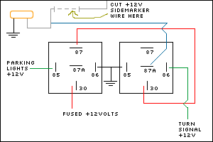

post Jul 19, 2005 - 6:14 PM
Modifying the side markers to blink is simple, either at the same time as the turn signal or alternating with the turn signal. All you need is one SPDT relay...you should use two but one would work.
Terminal 85 - one of the blinking turn signal wires
Terminal 86 - ground
Terminal 30 - parking lights +12 volts(actually, you'd want another relay for this)
Terminal 87a - light-side of the cut sidemarker +12v wires (if you want the sidemarkers to be on when the parking lights are on but turn off when the turn signals are blinking.
Terminal 87 - light-side of the cut sidemarker +12v wires (if you want the sidemarkers to be off when the parking lights are on but blink when the turn signals blink)
Aren't the accent lights 194 bulbs in the projectors though? A 194 bulb can't put out enough light during the day to be visible in direct sunlight.

What exactly do you want to do? Sidemarkers on until the turn signals blink and then they turn off? Or vice versa, with the sidemarkers off until the turn signals blink and then the sidemarkers blink too?
post Jul 20, 2005 - 6:52 PM
Well, if you want the sidemarkers on except when the turn signals are blinking, here's how you'd wire it up. Those big squares in the middle are just SPDT 30/40Amp automotive relays...you can find them at your local auto parts store or Radioshack.
