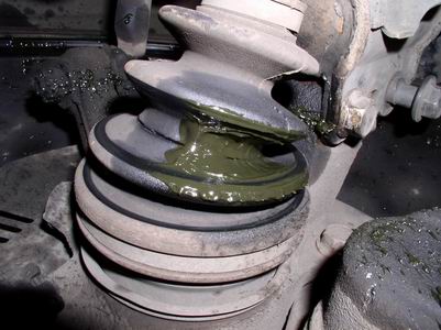

My driver's side CV boot is torn I think. frown.gif Some pics are below.
Is this a torn CV boot? If so, should I just replace that, or should I replace the whole axle? I absolutely hate pulling axles out and had issues with my axle not sealing at the tranny for a good three months last time my axle was pulled on the driver side. mad.gif

You'll probably have to take the axle out to put the new boot on anyway.
However, it doesnt look like you lost much grease. Mine were almost all empty and washed out and dirty.
If I was you, I'd try to just replace the boot. Like 12 bucks, make sure you repack the grease correctly as well.

If you're pulling the axle just to replace the boot you might as well replace the whole axle. You DO NOT wand to do it twice. Do you know how long that axle has been in there? If it's original I'd just replace the bitch and be done with it.

is it making any noise? if its still nice and quiet, you can just replace the boot. they sell them at any car parts store. the most youll have to take out, it the axel out of the wheel hub, but you shouldnt have to take it out from the tranny to do the boot. the boost kit will also come with new grease and everything u need to do the job.
the hardest part about replacing axels is getting a good rebuid from the car parts store. so unless yours is making noise, just repair it.

I agree with this. I replaced a boot in my last car and it was not too difficult and a lot less expensive than a new axel.

Thats a bad idea, your axle will be bad in no time at all.
You will have to pull the whole axle to replace the boot, there is a lock ring that holds the end of the axle on, and you have to put it in a vice, and knock the end off with a hammer and punch. I've done this to both sides of my car.
As to replace just the boot or the axle its up to you, if the axle is not poping when you turn or accelerate or brake, its like $100 for a new axle or $12 to $30 for a new boot depending where you get it at. It took me about an hour or so to take the axel off pop the end clean it out and put the new boot back on and put it back in.
Personally I would just change the boot if the axle is good, because like someone said you don't always get a good rebuilt axle.

As someone who's replaced both CV boots without touching the axles (several years ago, and several years apart) a quick inspection will tell you if the axle is bad.
Unless grit has worked its way in, you should be fine. Judging by the way it's leaking grease, you caught it early and won't have any issues.

I went ahead and ordered a rebuilt axle from this local place that has a very good reputation. It will cost $70 with the core discount and will be here tomorrow. I'm currently stuck on pulling the axle out of the tranny...I can't really find a way to get good leverage, but I think with two people we can somehow get it off. So when my dad gets home he's going to help me. I'm just hoping we don't damage the seal, because the AT200 C52 seals do not fit the AE101 C52 tranny.

And good idea to replace the axle. Usually a ripped boot allows dirt to get in and can damage it. This doesnt happen all the time, but better safe then sorry. And there's usually like metal rivets, or grooves or whatever you wanna call them to use to punch the axle in and out with a chizel or whichever tool works or you have. At least this is how it was in the 3 or 4 cars i have worked on, including my Celica. Either way, good luck and hopefully everythign turns out well.
