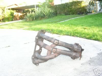

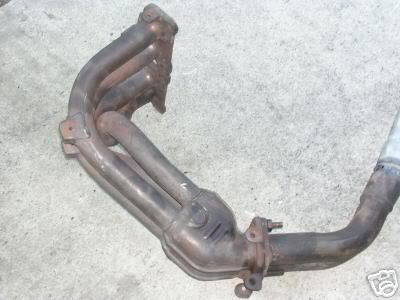

This was a 3SGE manifold with the downpipe that I came across on Ebay a long while ago:
